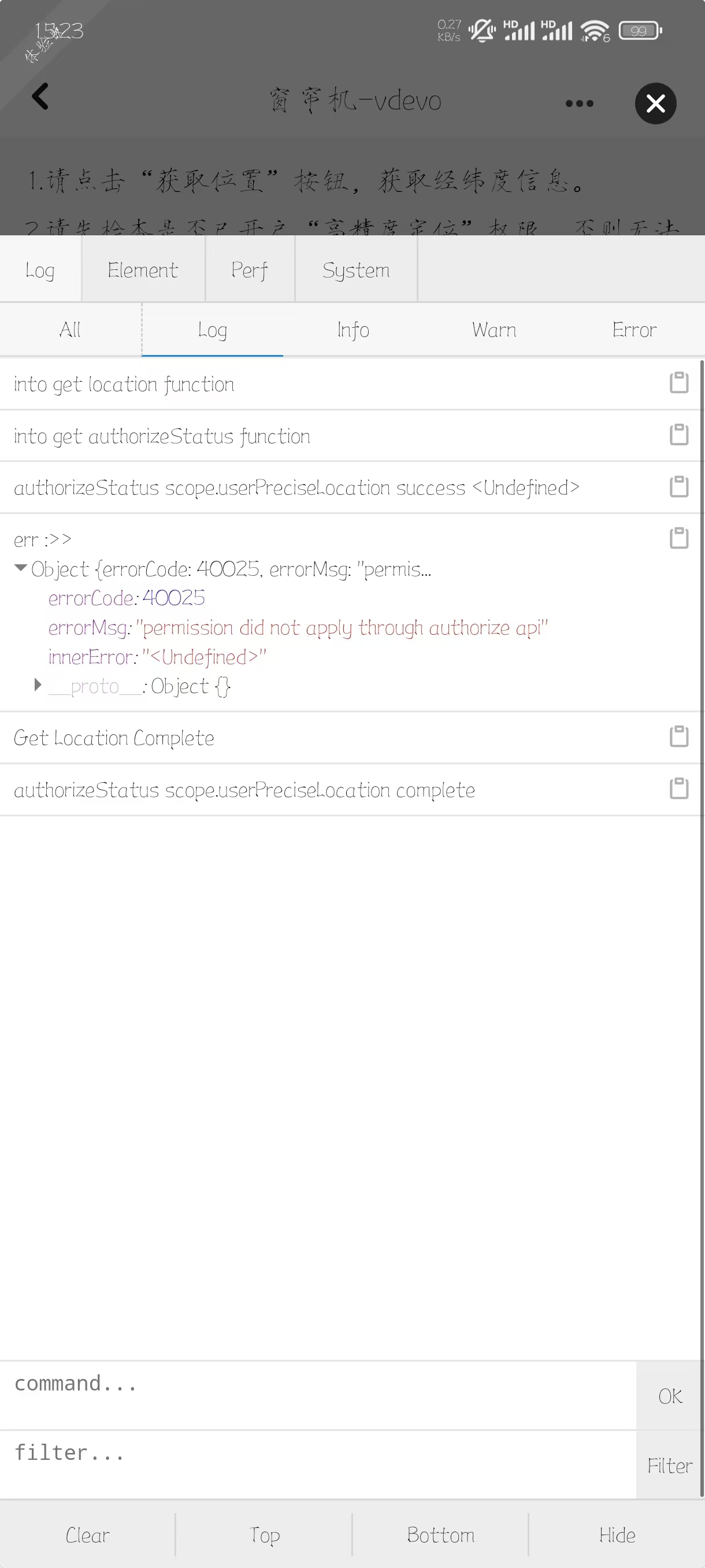

在已开启定位权限的情况下,调用getLocation方法,在真机调试的时候能获取到经纬度信息,在体验版获取不到,报错信息:{"errorCode": 40025, "errorMsg": "permission did not apply through authorize api", "innerError": "<Undefined>"}

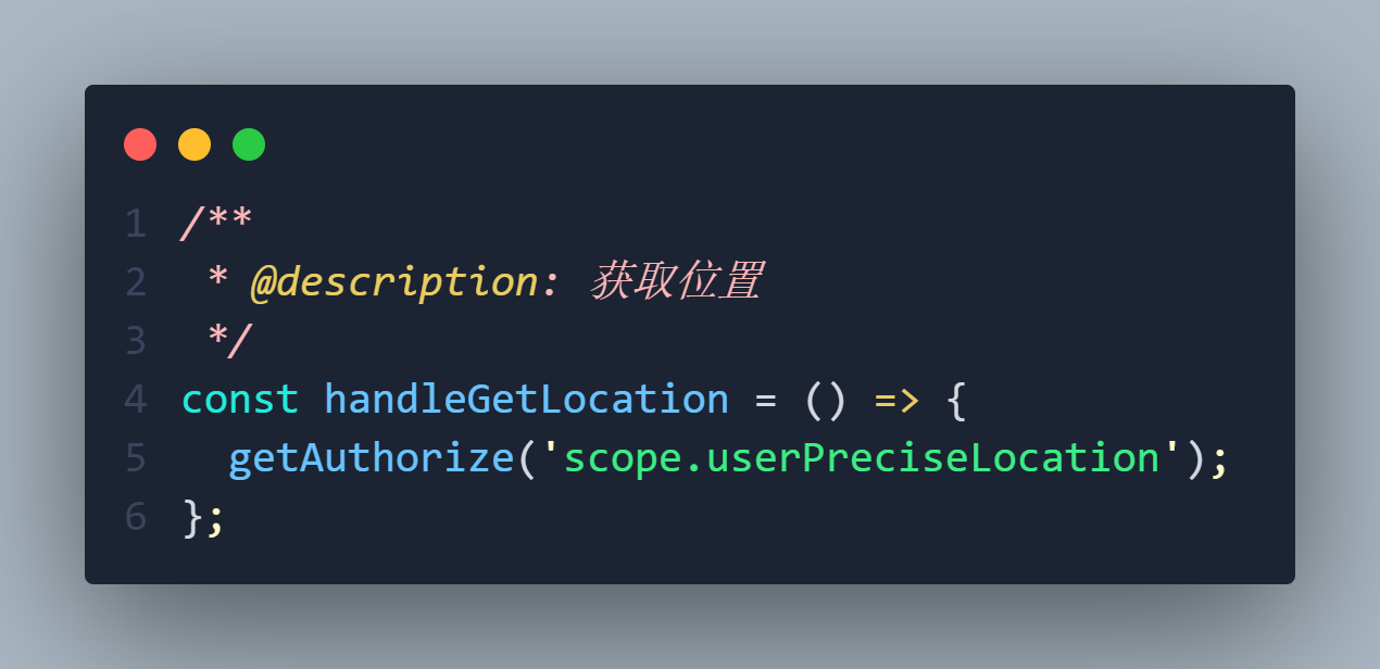

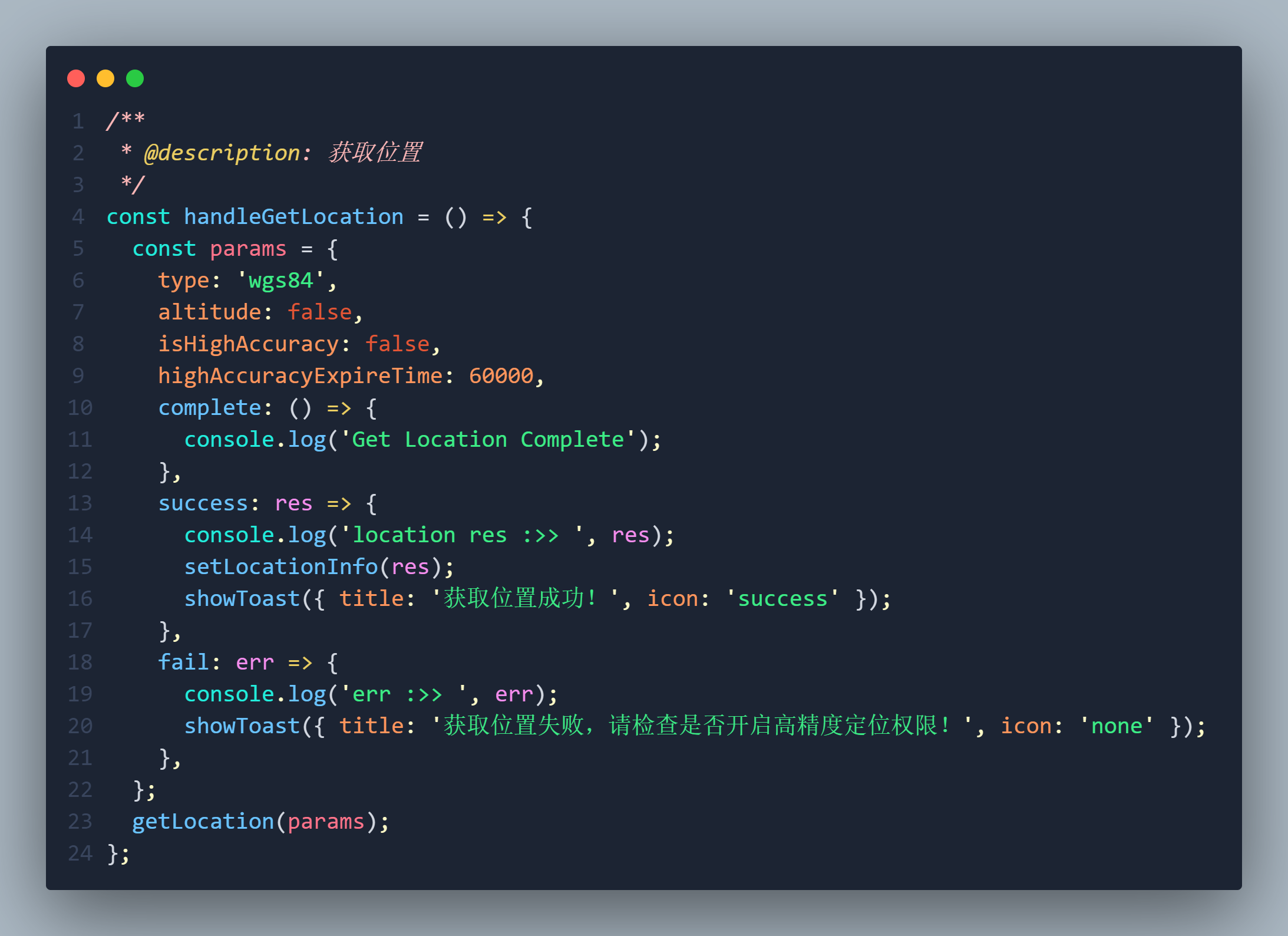

,最开始是这么写的,在真机调试可以拿到位置,在体验版不行,在群里问过之后,改成了这种写法

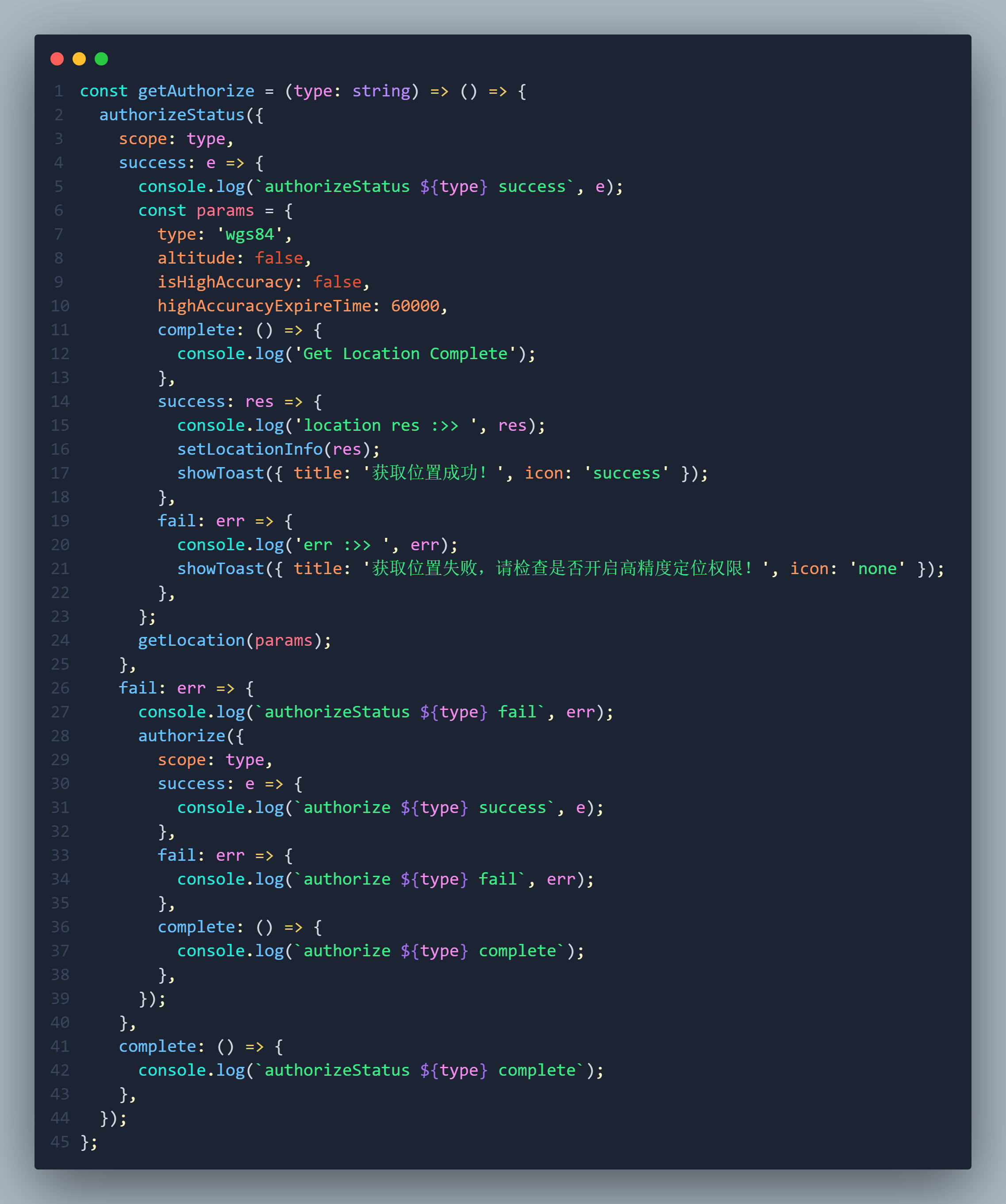

,这样写之后,无论是在真机还是体验版,都拿不到,complete回调都没触发,手机看控制台没有任何输出信息。

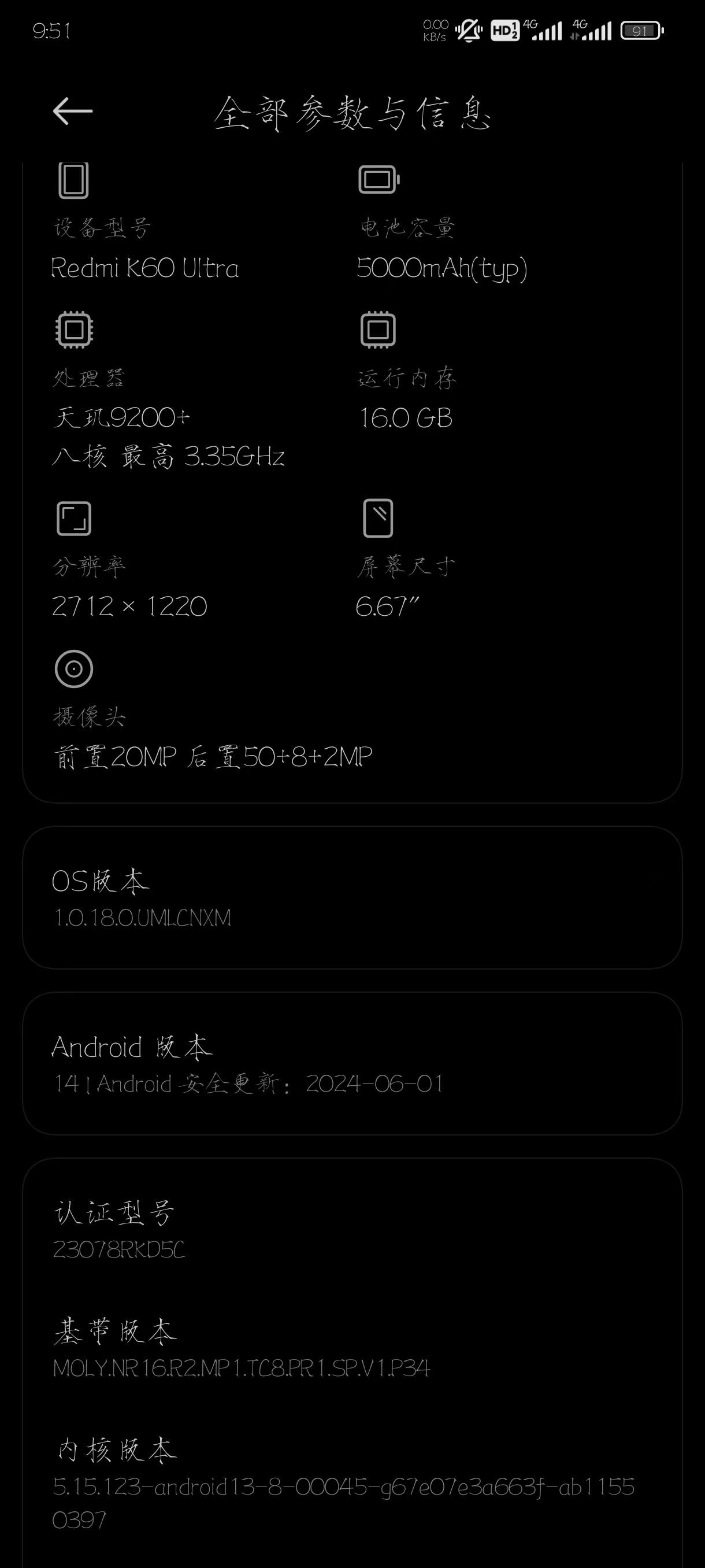

麻烦根据这个模板提供下相关信息吧,我们这边尝试了一下,iOS(App 5.15.0) 和安卓(App 5.16.0)均能正常获取
  • 0.7.0, Minipack: 2.1.0
  • 5.16.1
  • "@ray-js/panel-sdk": "1.10.0",
  • 型号:Redmi k60 Ultra,系统:HyperOS

  • 确保在 getLocation 之前正常授权了 scope.userLocation 低精度定位权限或 scope.userPreciseLocation 高精度定位权限,具体文档见 https://developer.tuya.com/cn/miniapp/d ... #authorize
    authorizeStatus({
      scope: type,
      success: e => {
        console.log(`authorizeStatus ${type} success`, e);
        const params = {
          type: 'wgs84',
          altitude: false,
          isHighAccuracy: false,
          highAccuracyExpireTime: 60000,
          complete: () => {
            console.log('Get Location Complete');
          success: res => {
            console.log('location res :>> ', res);
            setLocationInfo(res);
            showToast({ title: '获取位置成功!', icon: 'success' });
          fail: err => {
            console.log('err :>> ', err);
            showToast({ title: '获取位置失败,请检查是否开启高精度定位权限!', icon: 'none' });
        getLocation(params);
      fail: err => {
        console.log(`authorizeStatus ${type} fail`, err);
        // 检测权限状态关闭 申请权限
        authorize({
          scope: type,
          success: e => {
            console.log(`authorize ${type} success`, e);
          fail: err => {
            console.log(`authorize ${type} fail`, err);
          complete: () => {
            console.log(`authorize ${type} complete`);
      complete: () => {
        console.log(`authorizeStatus ${type} complete`);
根据console信息来看,权限确定是已开启的,但是在调getLocation时触发了fail
