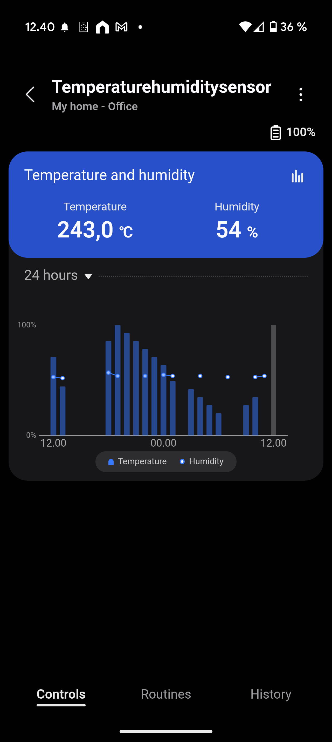

Somehow the values are off by the decimal, so e.g. 25,0 degrees Celsius is showed as 250 degrees. That is consistent across all sensors. Please see attachments.

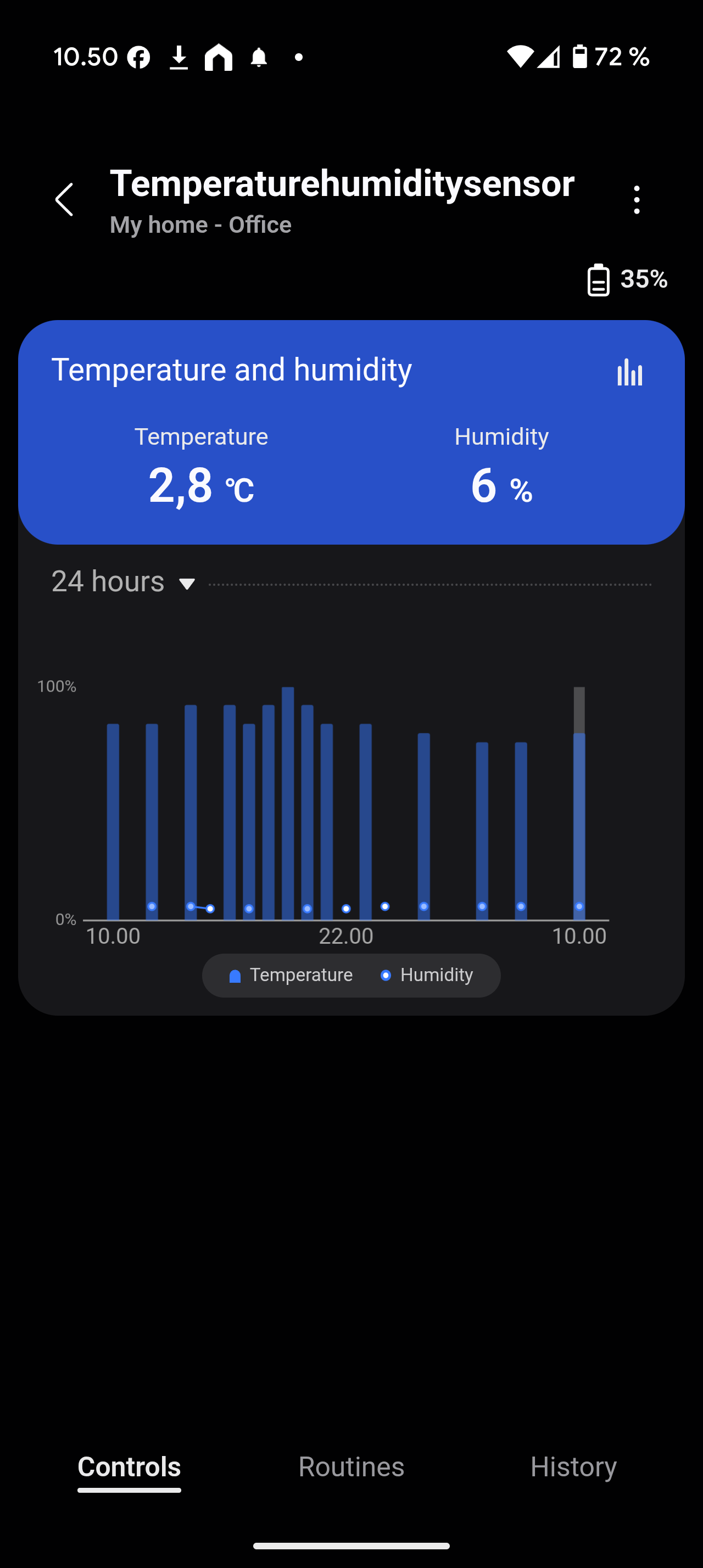

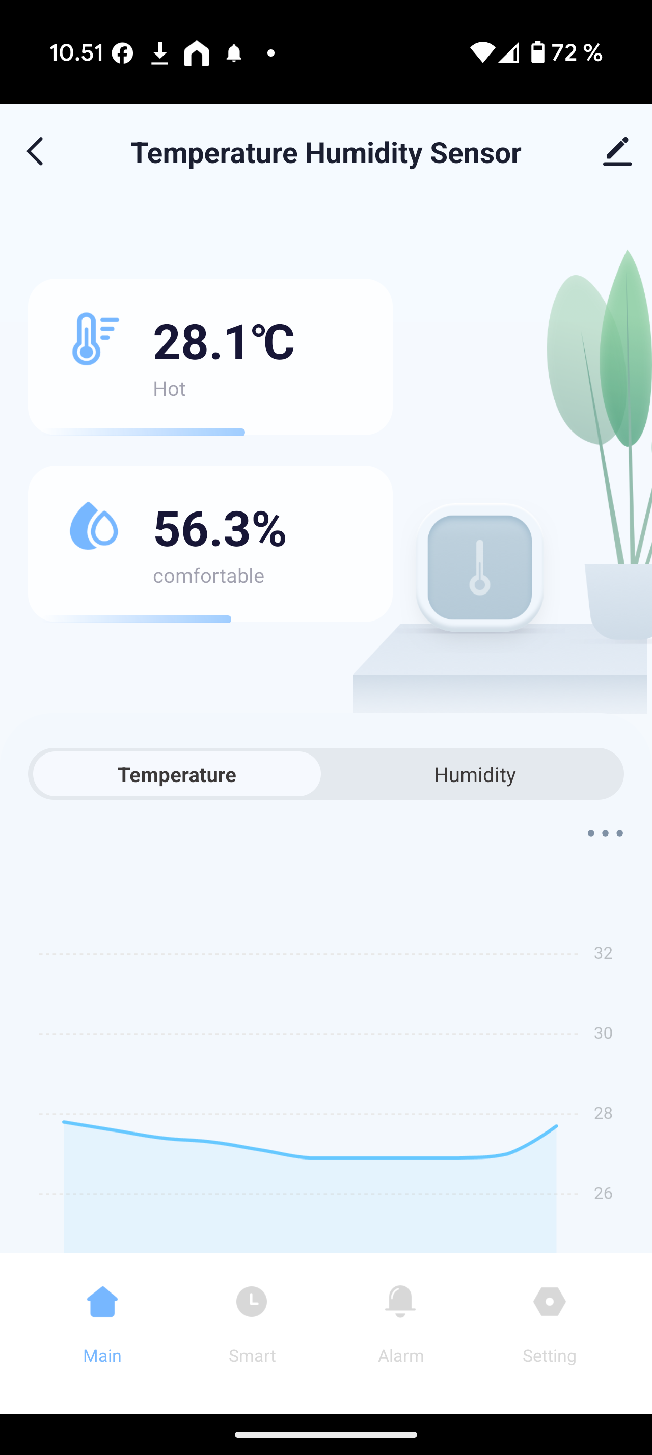

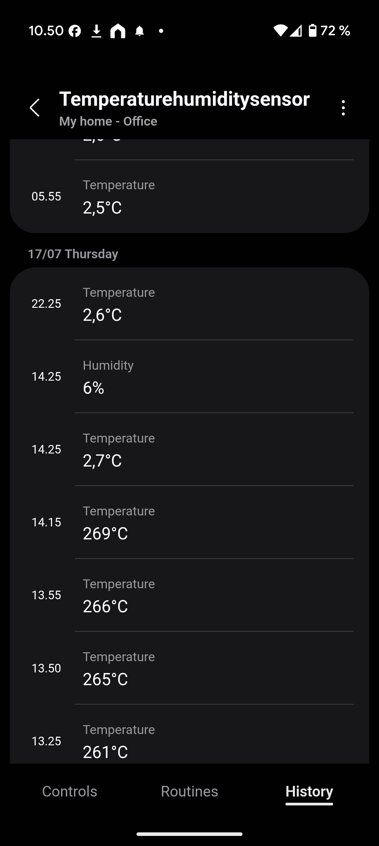

Thanks again for helping me out, the changes did help but now they are represented by a single digit. 28c is now represented as 2,8c
Please see pictures below.

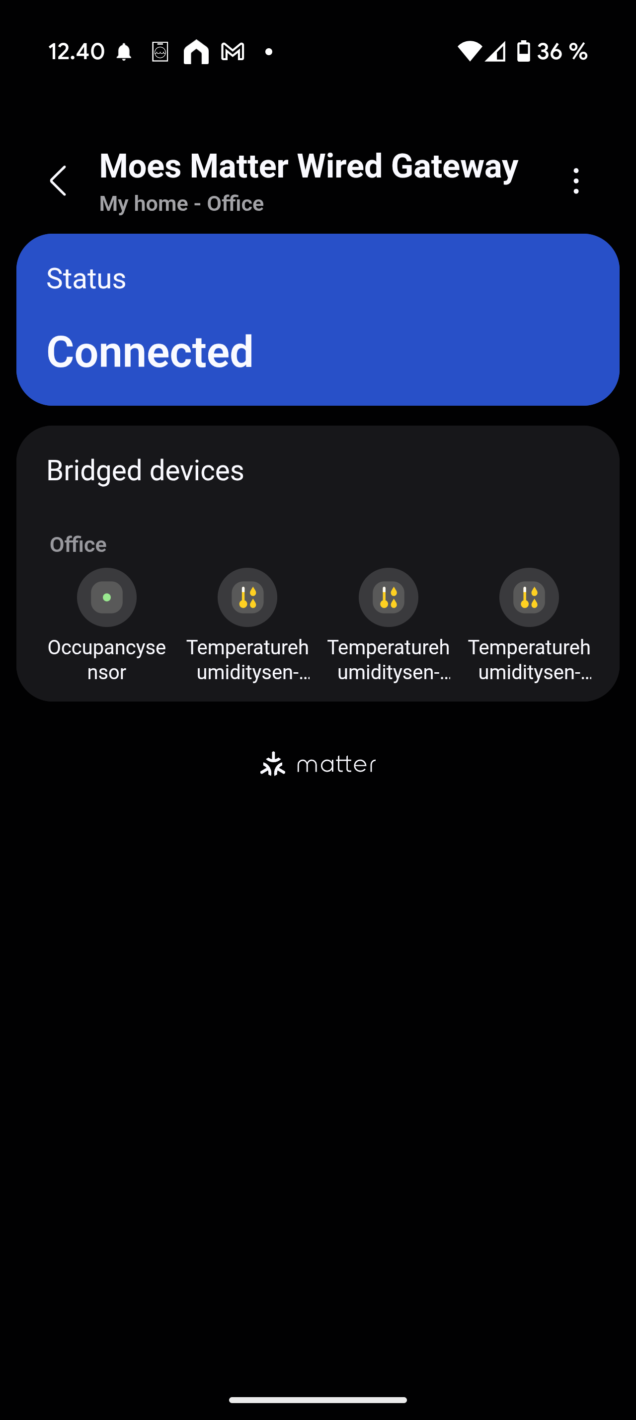

I have also added 3 new sensors, same model as the one already working but I have forwarded you the id's just in case you need to change any values.

Which of the following do you mean:
1) Tuya app shows 28.1 Celsius while smart thing shows 28°. Lack of precision after the decimal point.
2) Tuya app shows 28 degrees Celsius while smart thing shows 2.8 degrees Celsius. Scaling is still incorrect.

apologies for the misleading information.
My main issues is #2, the scaling is still incorrect.
The precision is not a problem for me, but was to show the difference between Tuya app and Smartthings.

Thanks for the clarification, I understand now.
I modified the config files for Soil 1 bfedea2d2a045fcb49nleo, Soil 2 bf14667602e202fba7cudu, and Temp sensor bf337d961e46511367w3qt, please try again.

Yes, you did it again! The temp is now showing as expected, great job.
Would it be possible to have the humidity part working in the same way as temp?

Okay, the same scaling has been configured for the three devices.
