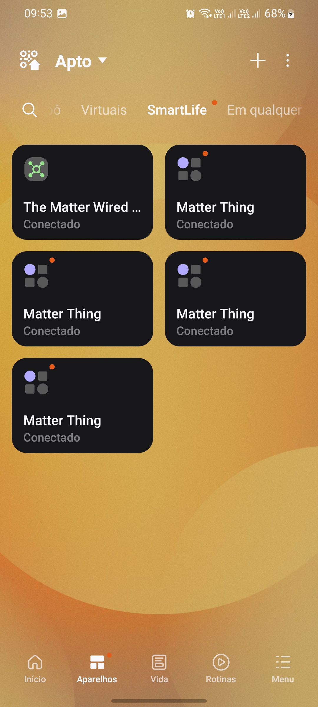

Hi Tuya Forum.

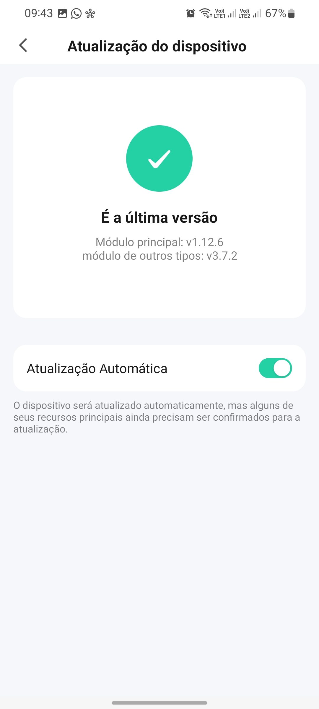

I have a SmartThings v3 hub with firmware 000.057.00014 and 4 Zigbee devices paired to the Nova Digital Matter and Thread (Moes Tuya) hub running firmware v1.12.6.

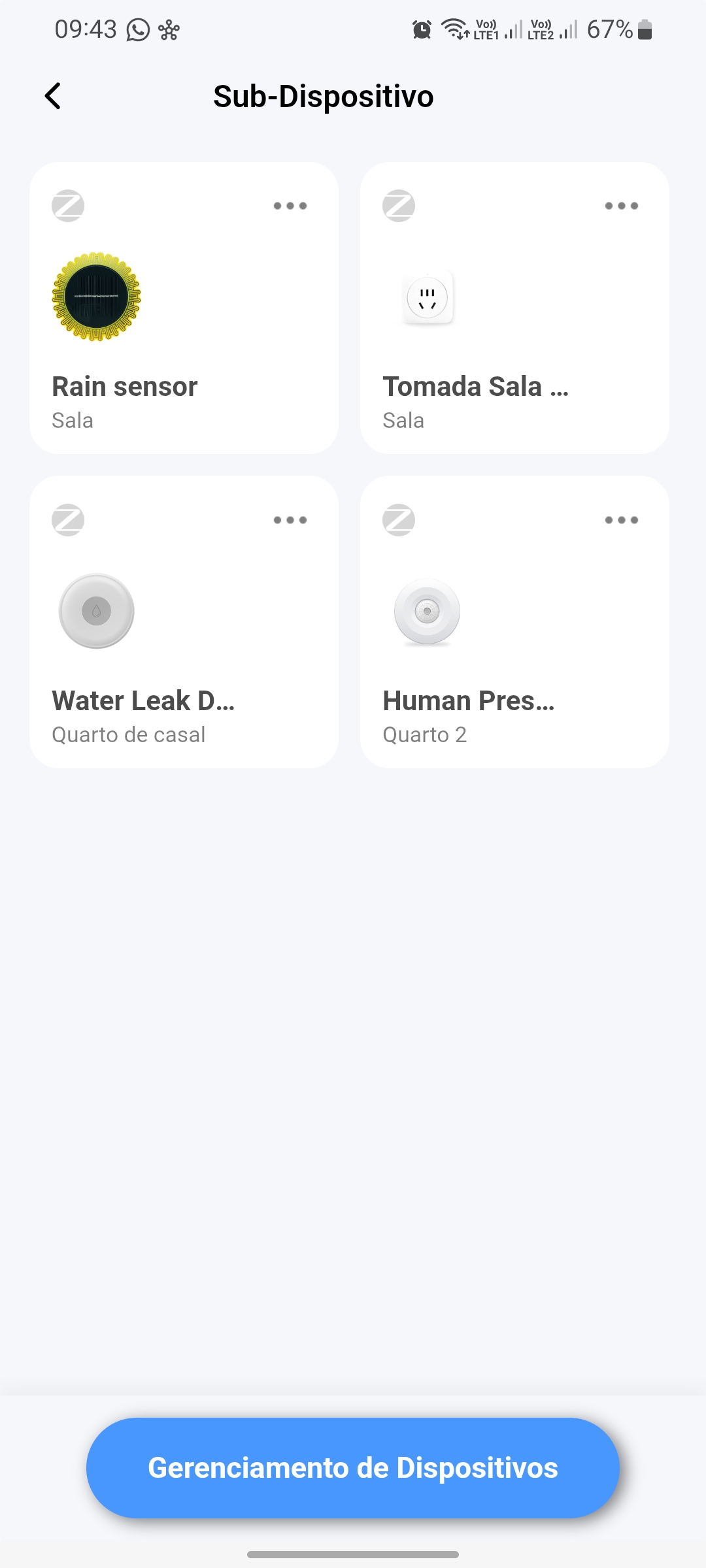

At first, I was able to successfully export the 4 devices via Matter to SmartThings. However, over the past week, these devices frequently went offline, so I deleted them from SmartThings. Since then, I’ve tried to pair them again via Matter numerous times, but all 4 devices appear as Matter Thing in SmartThings and do not function. On the Tuya Matter hub, however, they work correctly.
Can you help me?
Matter Hub
Main module: v1.12.6
Other type: v3.7.2
Virtual ID: ebdf6bd3dd0b03de4dgsj0
Devices:
Rain Sensor v1.0.3
Virtual ID: eb03bdf2446c4c61b007hl
Switch v1.0.1
Virtual ID: ebf62f9d43486175e1csbq
Water Leak Detector v1.0.3
Virtual ID: eb0a384a3e15a2ac29nskz
Human Presence Sensor v1.0.6
Virtual ID: ebad18a48ccf82b104kmwo

A question: Shouldn't the Matter gateway be updated to version 1.13.8 to solve this problem?
fangping.guo
Posts: 255
Re: SmartThings + Moes Matter not working

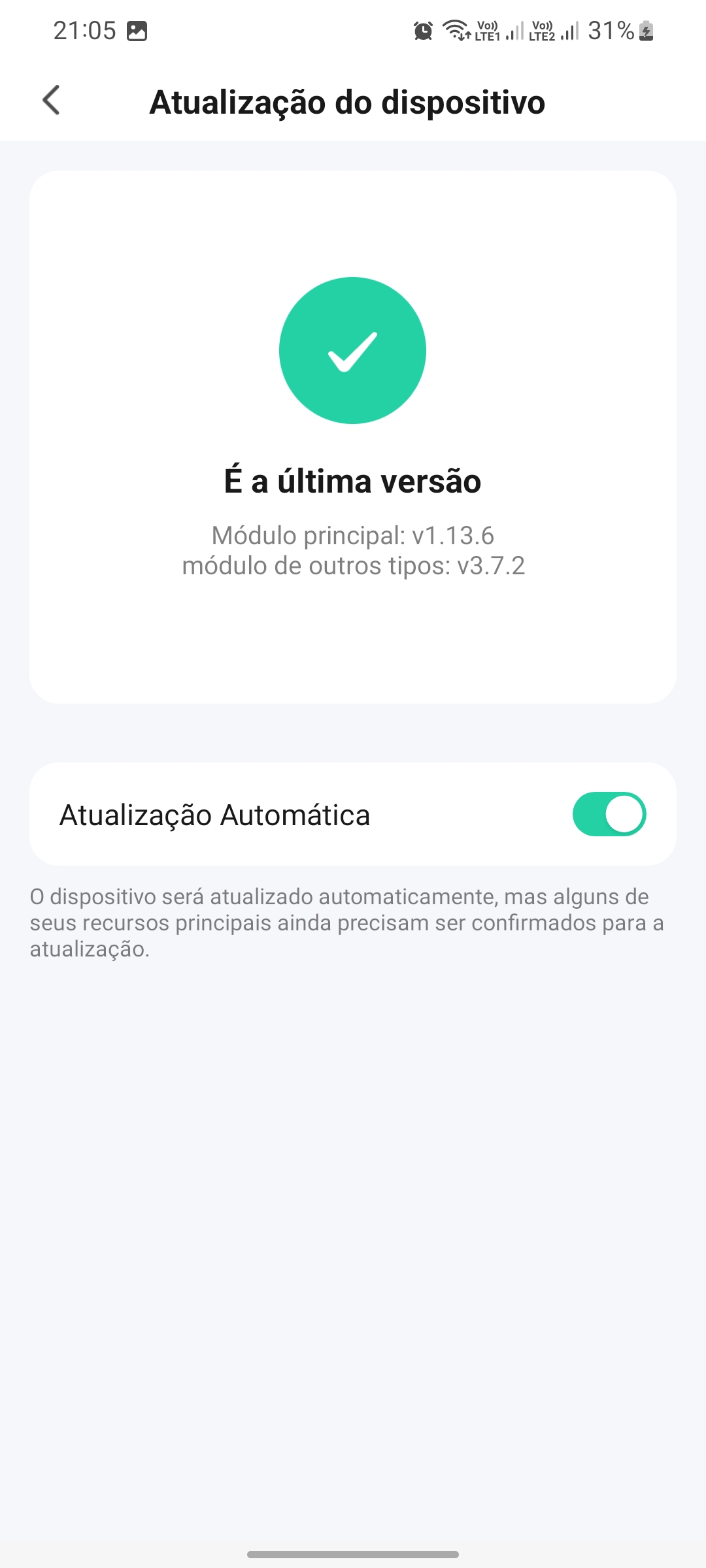

Ok, I configured the upgrade whitelist for your device and you should now be able to receive the 1.13.6 version push. Please test again.
reinaldots
Posts: 7

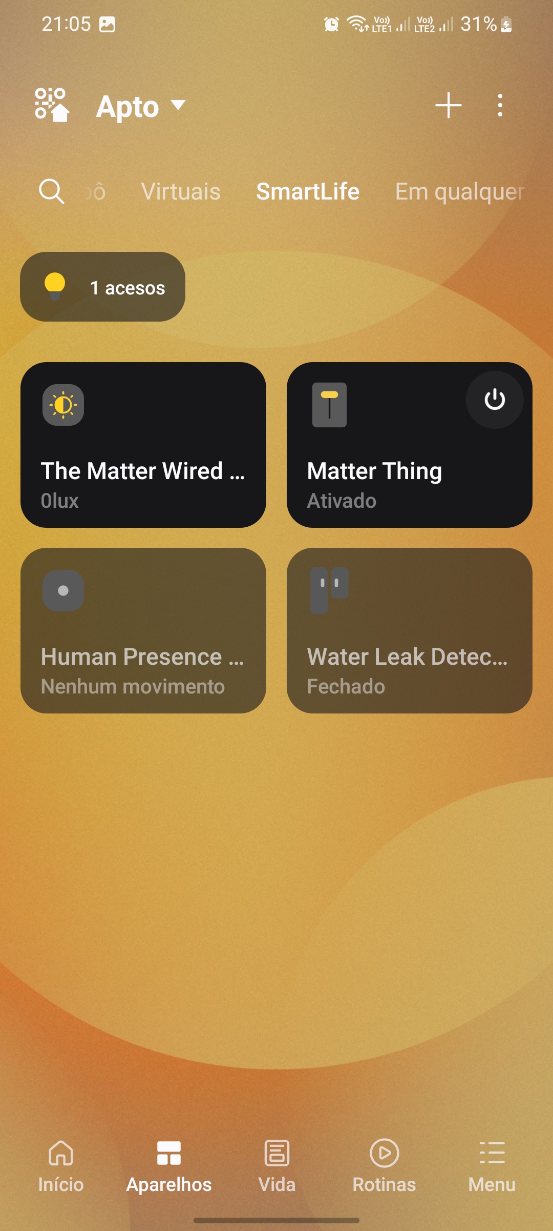

Hi,
After updating the Tuya hub to version 1.13.6 and restarting both hubs, 2 devices exported via Matter started working on the SmartThings hub: Human Presence Sensor and Water Leak Detector (all exported with the name "Matter Thing", I renamed the 2 that are working).
The on/off smart plug does not work in SmartThings and is stuck in the "On" status.

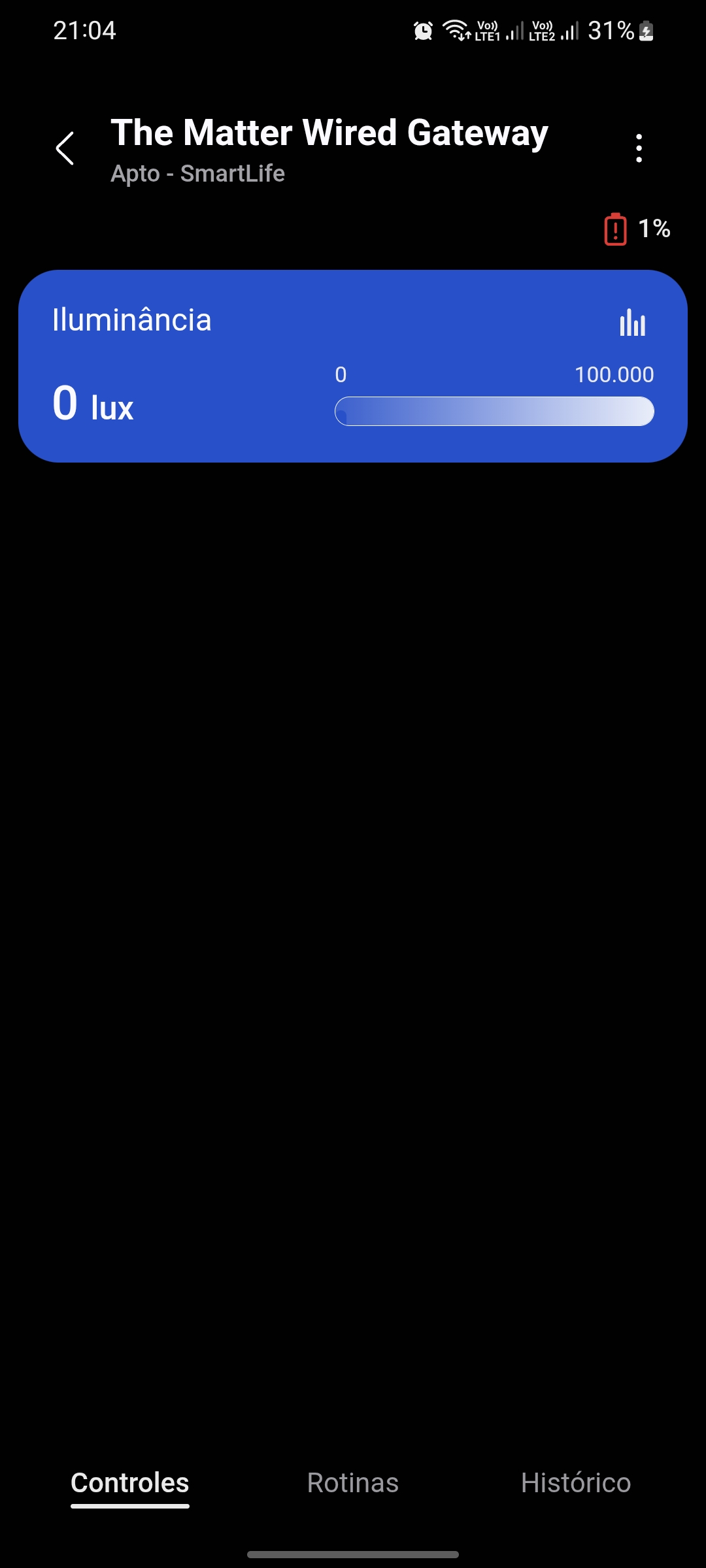

The Tuya hub was exported as "The Matter Wired Gateway" with 2 sensors that do not exist on it: luminosity and battery. It frequently displays the battery at 1%, triggering a notification in SmartThings to replace the low battery.

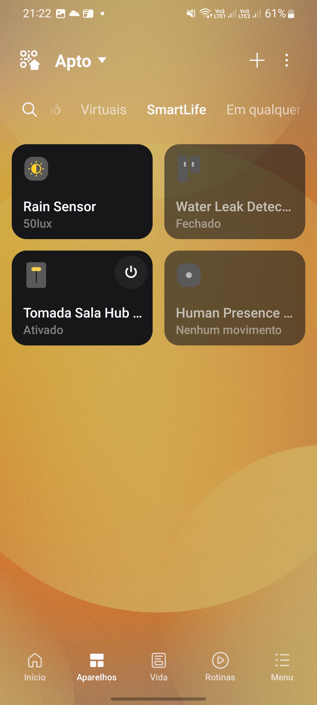

reinaldots
Posts: 7
I apologize, "The Matter Wired Gateway" is actually the Rain Sensor, and I realized this by noticing the same luminosity value in both the Tuya/Smart Life and SmartThings apps.
The smart plug device is now working perfectly, and the Tuya hub is no longer exported via Matter with the four devices. This isn't an issue, as I don't need it in the SmartThings app.
Finally, is it possible to adjust the Rain Sensor to correctly display the battery level and rain detection status?

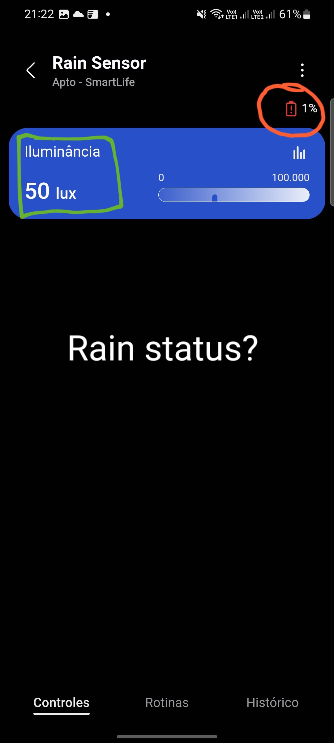

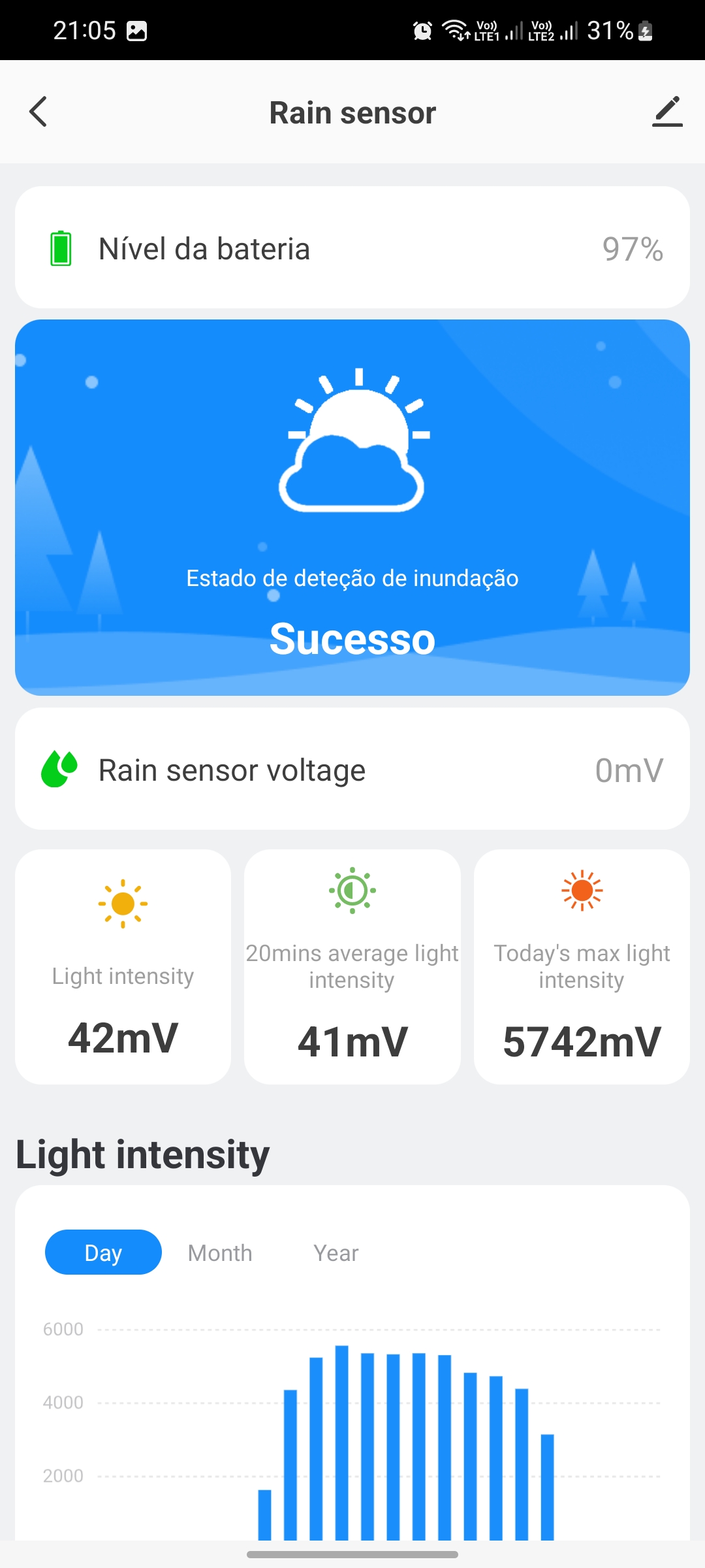

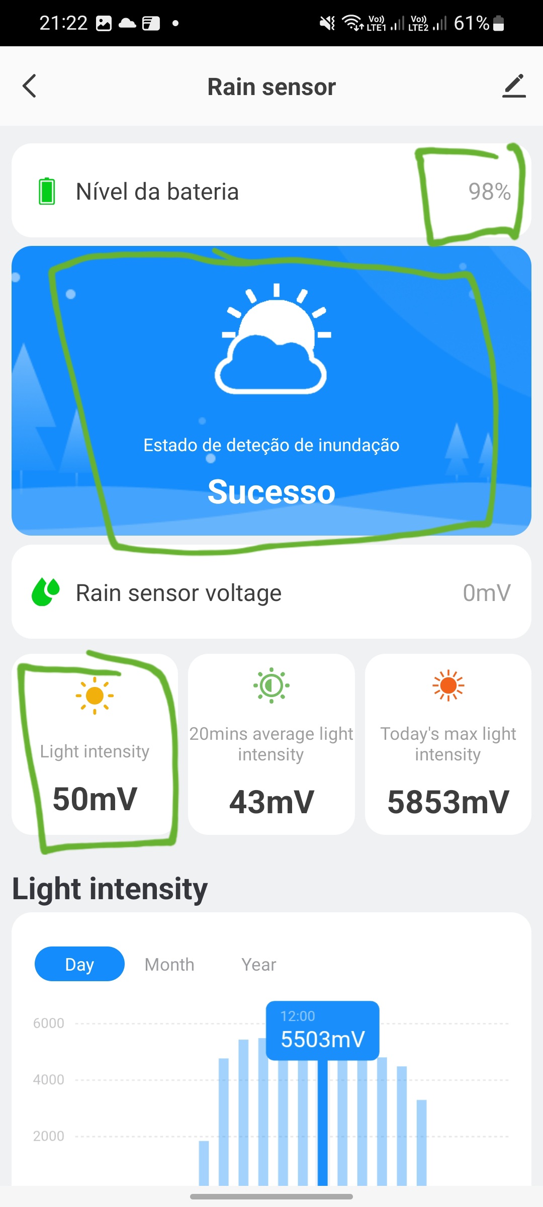

reinaldots
Posts: 7
Now it correctly shows the battery level of the Rain Sensor, thanks.
The Rain Sensor does not show the status (raining or not) exported to SmartThings. This is the most important function of this device, to know if it is raining or not, in addition to luminosity and battery.
Could you please adjust the Rain Sensor status to be exported via Matter?
