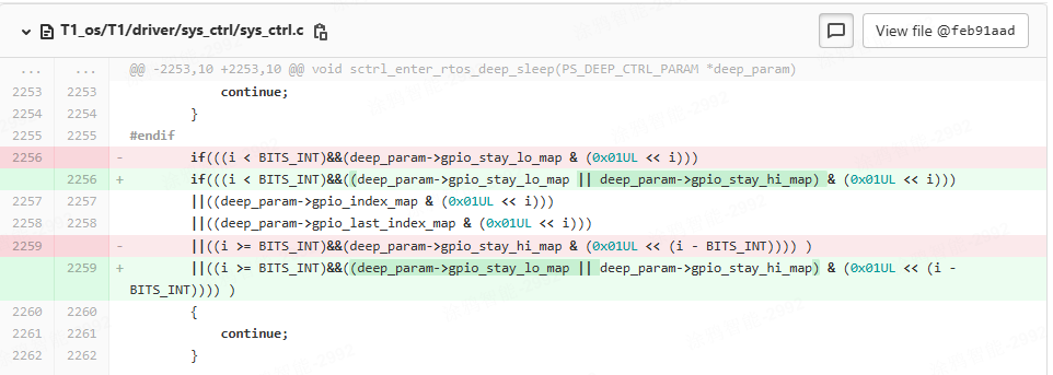

JSHANG
Posts: 107
Re: T1被不同GPIO唤醒后,调用tkl_wakeup_source_type_get获取到的gpio_num相同
您好,打上这个patch再试试:
T1_os/T1/driver/sys_ctrl/sys_ctrl.c
@@ -2253,10 +2253,10 @@ void sctrl_enter_rtos_deep_sleep(PS_DEEP_CTRL_PARAM *deep_param)
continue;
#endif
if(((i < BITS_INT)&&(deep_param->gpio_stay_lo_map & (0x01UL << i)))
if(((i < BITS_INT)&&((deep_param->gpio_stay_lo_map deep_param->gpio_stay_hi_map) & (0x01UL << i)))
((deep_param->gpio_index_map & (0x01UL << i)))
((deep_param->gpio_last_index_map & (0x01UL << i)))
((i >= BITS_INT)&&(deep_param->gpio_stay_hi_map & (0x01UL << (i - BITS_INT)))) )
((i >= BITS_INT)&&((deep_param->gpio_stay_lo_map deep_param->gpio_stay_hi_map) & (0x01UL << (i - BITS_INT)))) )
continue;

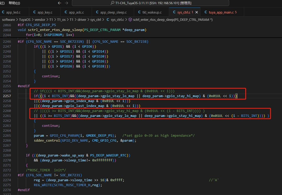

icemanhh
Posts: 24
修改后似乎没有变化,获取的还是最小的GPIO数值
JSHANG
Posts: 107
您好,
这个原因是deepsleep 唤醒后 bootloader 中对 gpio 进行了重新初始化,导致 app 中读取到的 gpio 中断状态已经是滞后的了;
如果修改,需要更新bootloader, 您需要更新解决该问题吗?

JSHANG
Posts: 107
  1. 打上wakeup_gpio_num_erro_patch.diff 修改
  2. 用附件中T1_bootloader.bin替换\vendor\T1\T1_os\tools\generate目录下的T1_bootloader.bin
T1_bootloader.rar
(28.25 KiB) Downloaded 4569 times
wakeup_gpio_num_erro_patch.rar
patch file
(819 Bytes) Downloaded 4565 times
