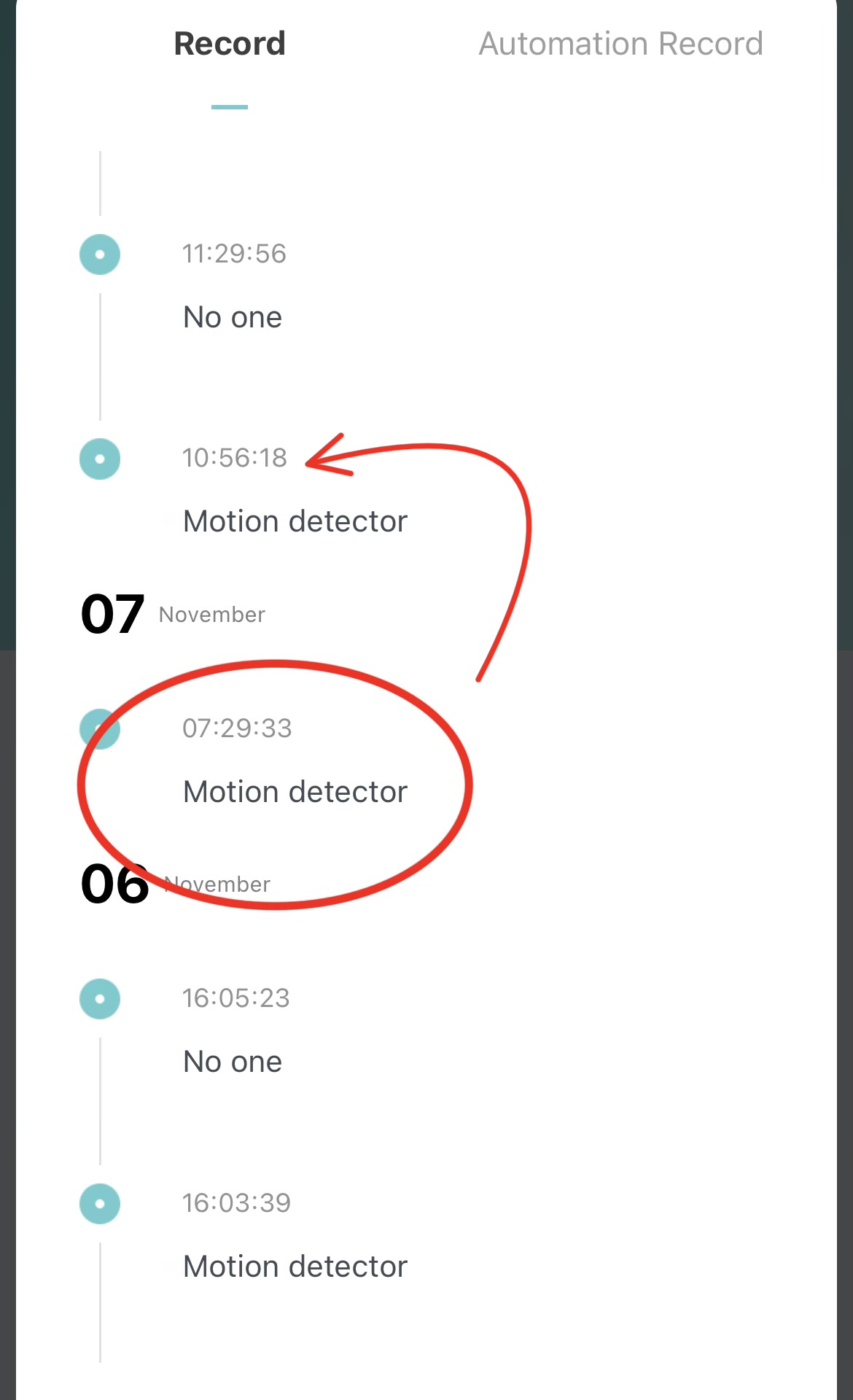

In this case there was a movement at 07:29 AM, and it locked as detected movement until I restarted it the next day at 10:56 AM
Virtual ID: eb08d7e21905b87dc5cnph
I'm attaching an image of the logs

HI,Thank you for providing the information.
We reviewed the device logs and initially determined that the device has been operating normally since November 6th, without any freezes or crashes.
However, we observed that the PIR and gateway seem to be quite far apart, or there is some interference between them. The signal strength between them is not very good.
Furthermore, your gateway also seems to frequently go offline and back online for short periods, which may be due to a poor router network, potentially causing the PIR to fail to report data to the cloud.
Therefore, we suggest you check the following two aspects:
  1. Are there any obstructions or interference between the PIR and gateway?
  2. Is the router's network stable?
