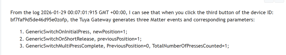

From the log 2026-01-29 00:07:01:915 GMT +00:00, I can see that when you click the third button of the device ID: bf7faf9d5de46d95e0zofp, the Tuya Gateway generates three Matter events and corresponding parameters:
  1. GenericSwitchOnInitialPress, newPosition=1;
  2. GenericSwitchOnShortRelease, previousPosition=1;
  3. GenericSwitchMultiPressComplete, PreviousPosition=0, TotalNumberOfPressesCounted=1;
I believe the events we sent are correct. Could you please inquire with Aqara whether they think there are any abnormalities in the events we sent? In their opinion, what events and parameters should be triggered by a single click, a double click, and a long press? If they could clarify the specific expectations for the different behaviors of the generic switch device type, I would be willing to make the necessary modifications.

fangping.guo 2026年 Jan 29日 10:14
