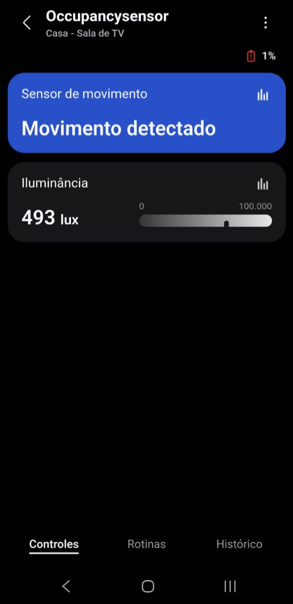

unnamedi
Posts: 24
Re: Presence sensor not imported matter
Thank you, it's working correctly. However, it came as a battery-powered device on SmartThings, but it isn't.
fangping.guo
Posts: 275
OK, I have updated and removed the battery function. You need to unbind the device, restart the gateway, and rebind the device to verify.
unnamedi
Posts: 24
It worked perfectly. Thank you very much.
