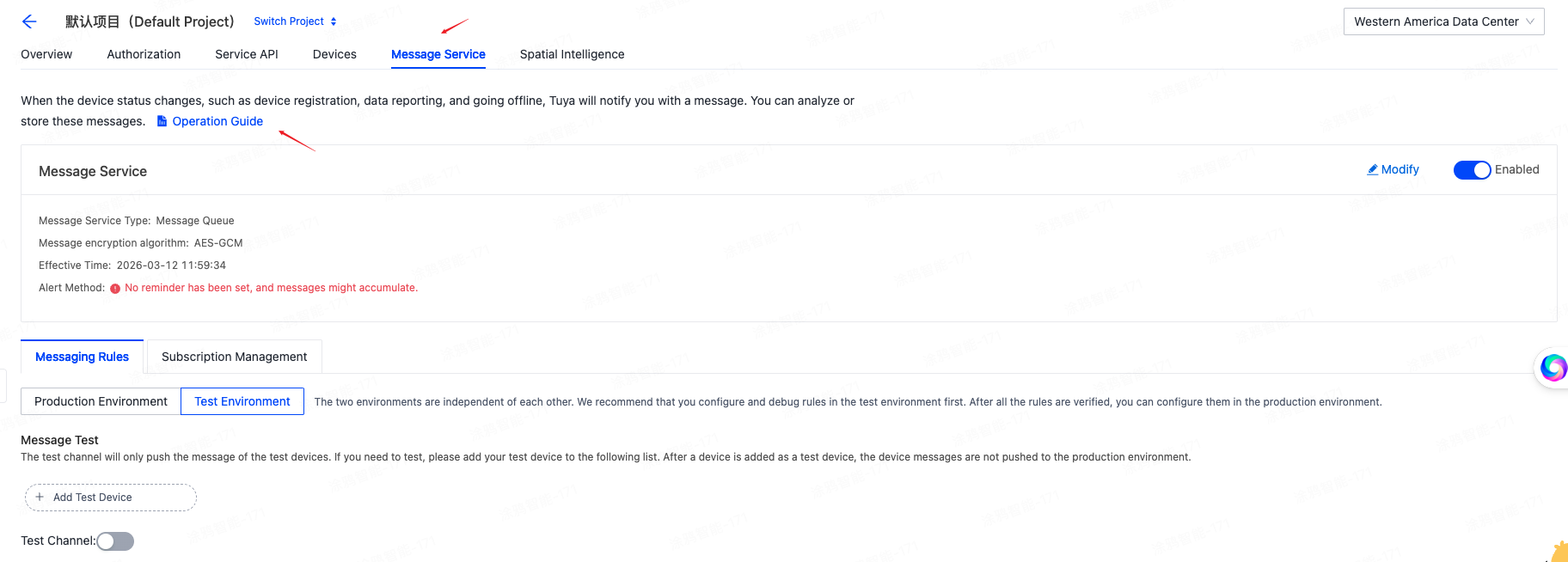

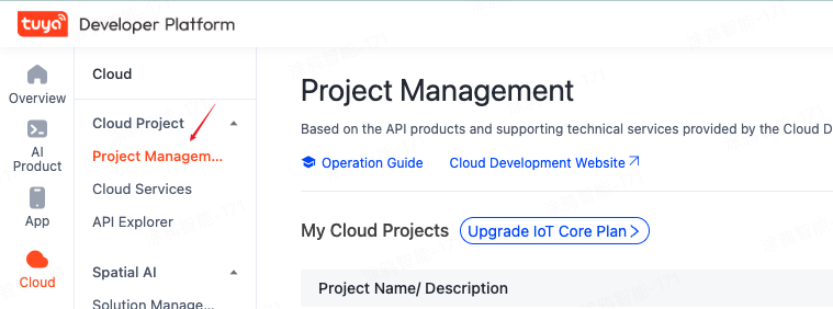

Ritchie
Re: Query Device Properties in Bulk
The path in the documentation is outdated. You can find the message subscription settings by following the screenshot below.
