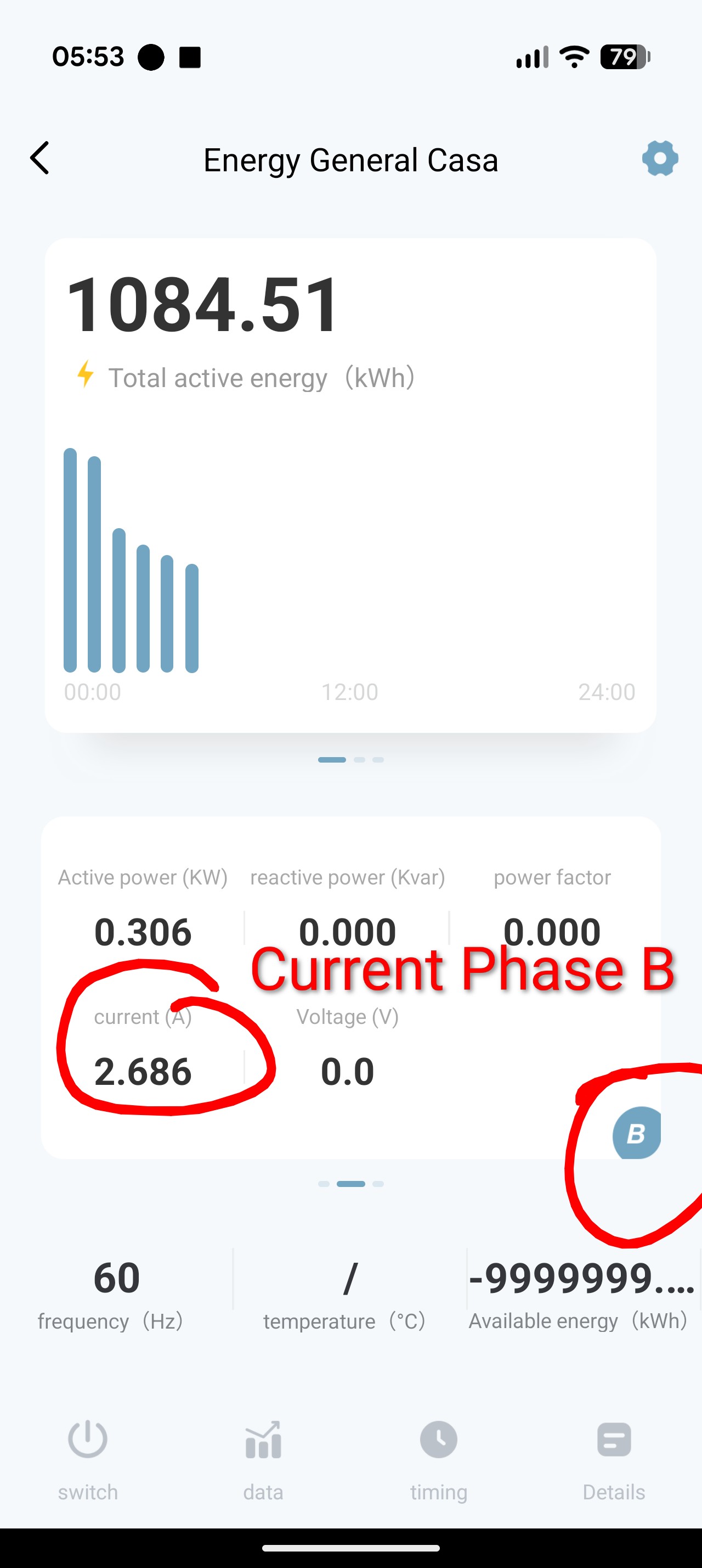

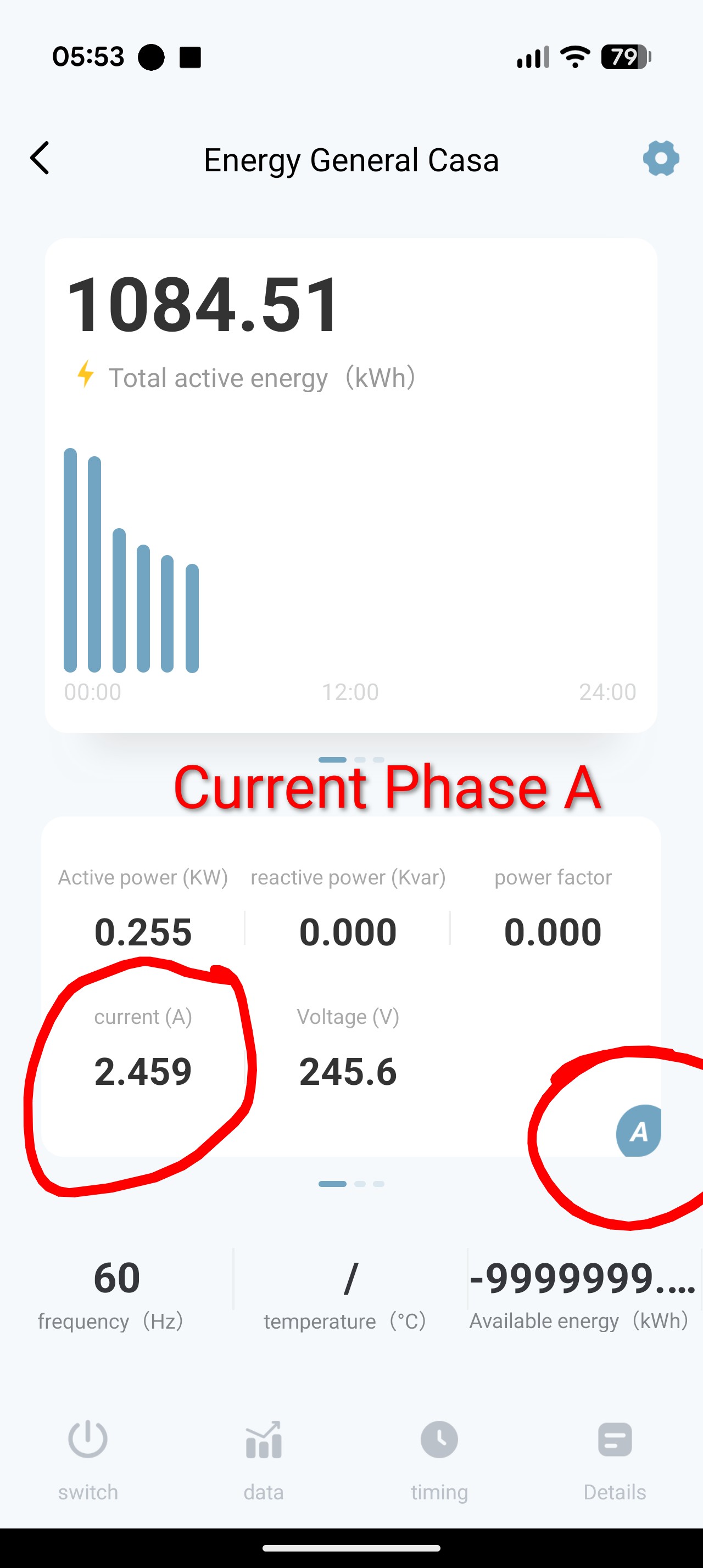

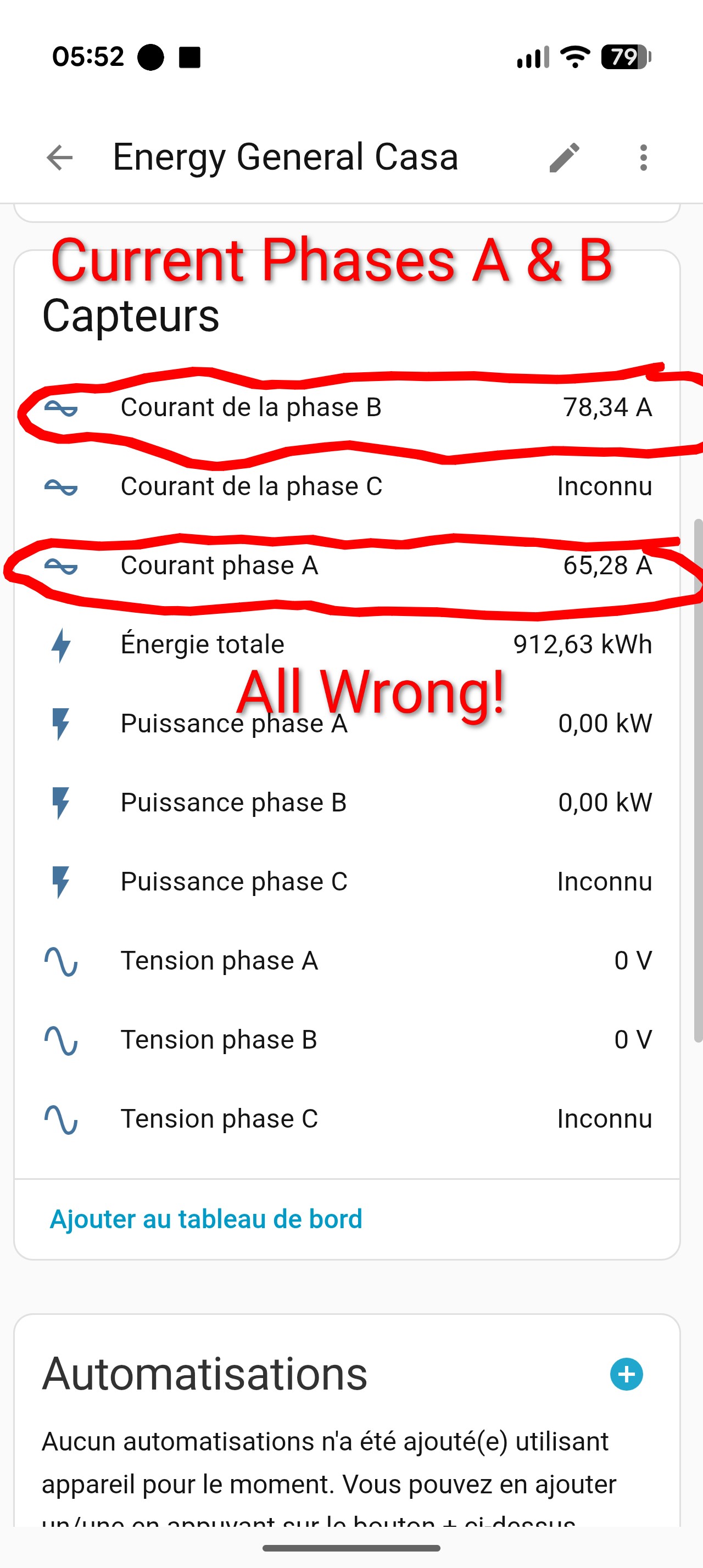

I am using an HIKING TOMZN DDS238-1 Wifi ampermetric smart meter and I am trying to get it to work properly with Home Assistant, specifically to monitor the Amperage for Phase A and Phase B.
I have tried using both the official Tuya integration and the HACS Local Tuya integration, but the data displayed are completely wrong in both cases, It looks like they can't really understand the RAW Base64 or Hexadecimal data coming from this device.
I precise that the values appear perfectly in the SmartLife app.

Home Assistant Official Tuya Integration wrong values
SmartLife App - Amp. Current Phase B correct value
SmartLife App - Amp. Current Phase A correct value
