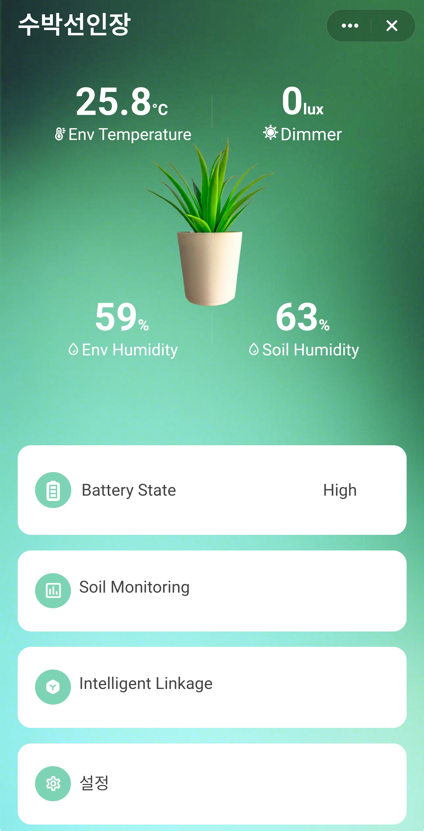

I added the device in the Moes app, but it doesn't sync with SmartThings. Please help me sync it.
Virtual ID : eb302b103960194db0bb3f

The device has been configured as a combined unit for temperature and humidity sensors as well as light sensing. You can restart the gateway and rebind the device for testing.

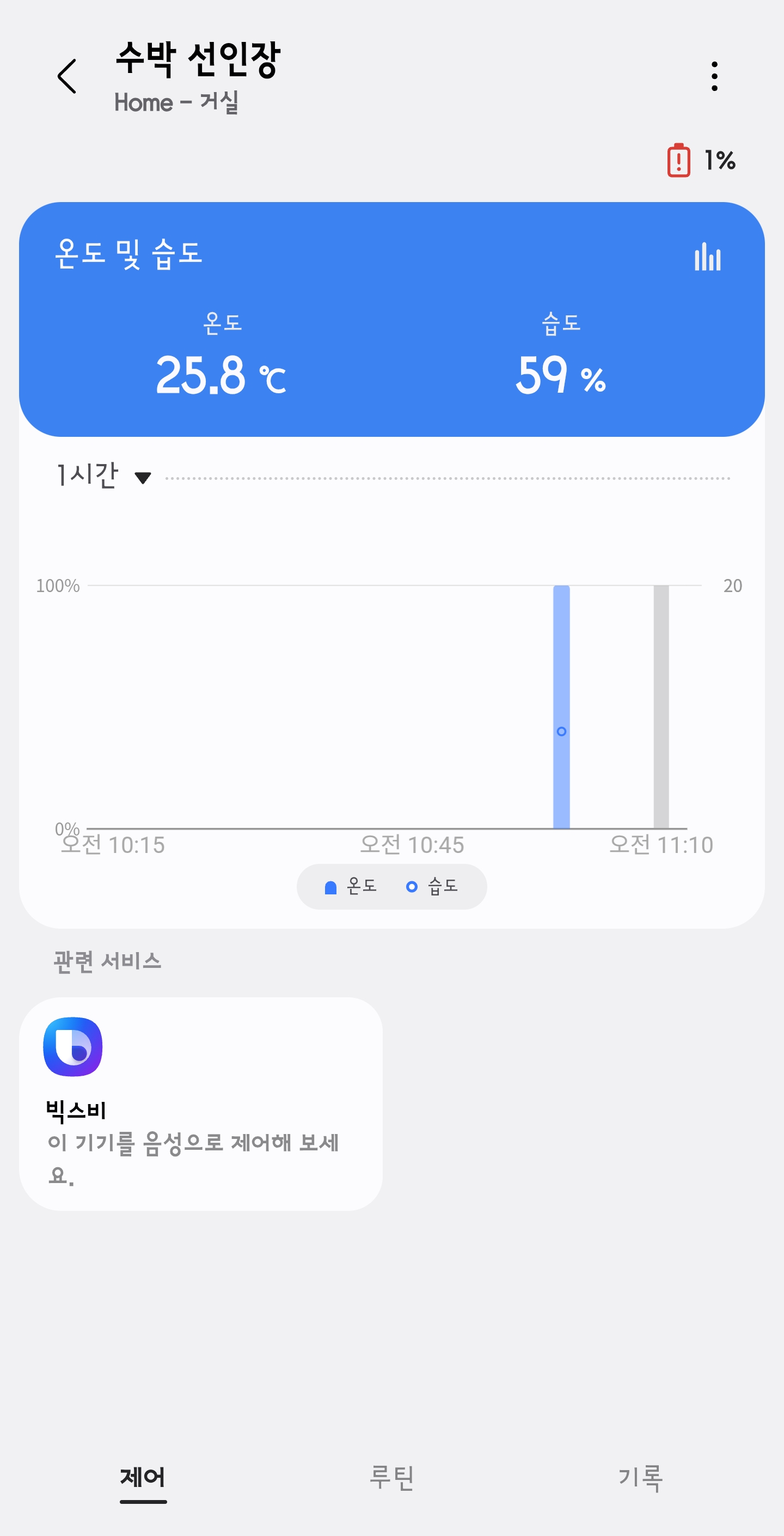

I rebooted and confirmed that 'temperature' and 'humidity' were measured. ‘Illuminance’ cannot be confirmed.
Additionally, is it impossible to measure ‘soil humidity’?

yes.
