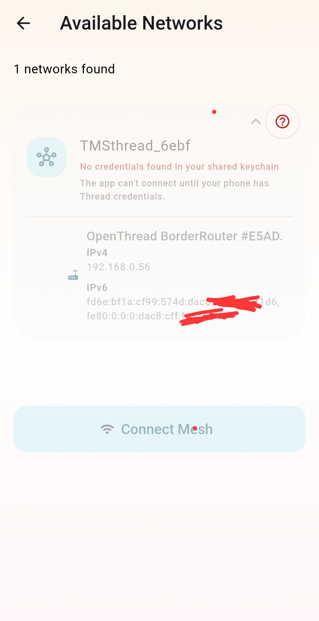

So basically it's not possible to add any matter over thread devices with iPhone and tuya app, it's keep asking for thread border router. Pairing working completely fine with android system.
I can use iPhone for pairing with other apps without any issues, or I can pair matter over thread devices with tuya iPhone app but only if I use 3rd party thread border router, router which already shared credentials with iPhone.
The reason is I think because tuya matter over thread hubs don't share credentials with iPhone. Same with android, but its working ok.
