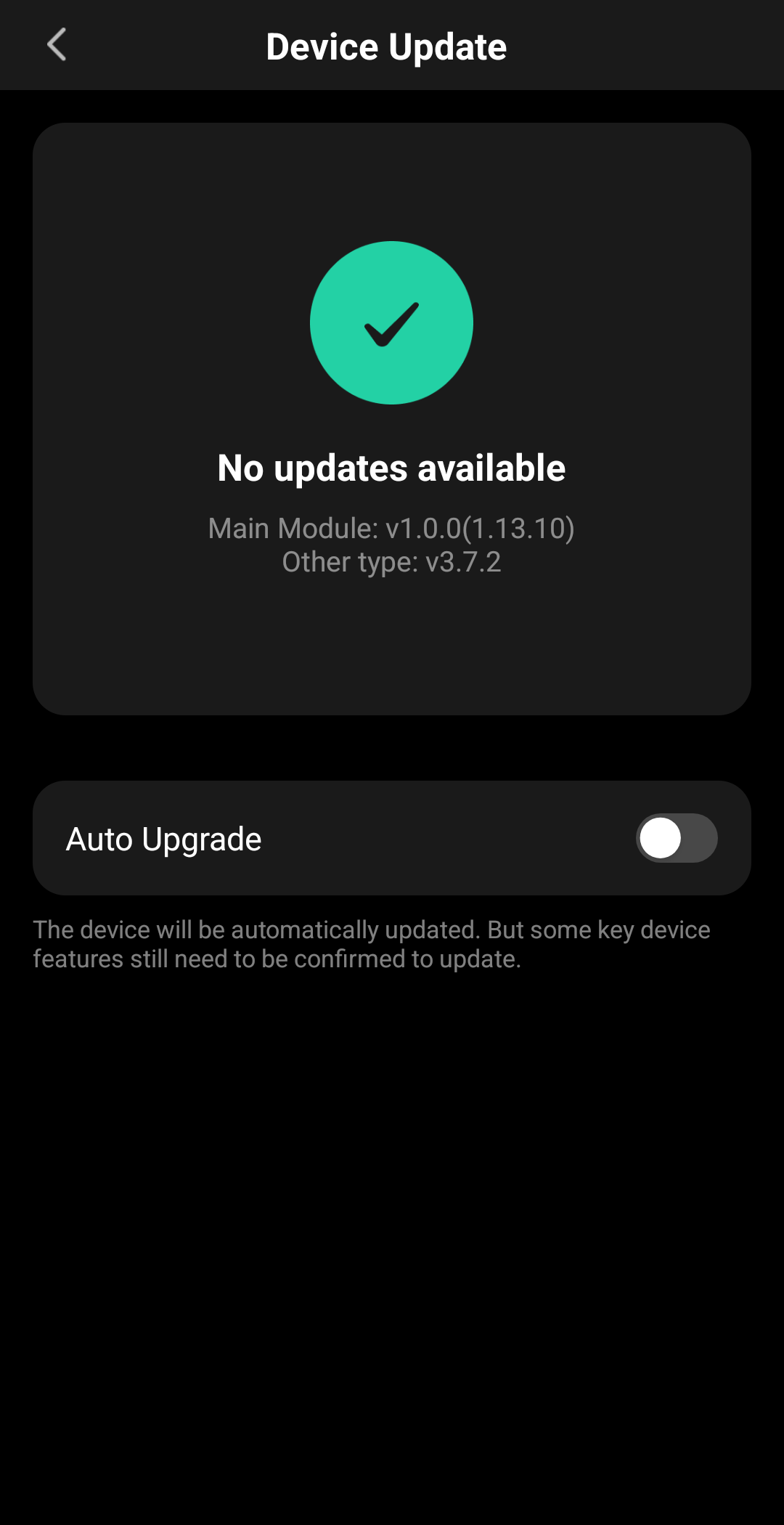

hi hi
no updates available, could you push it to my gateway? thanks ;d
virtual id of gateway: bf01ab90188976b3f7xqtl
