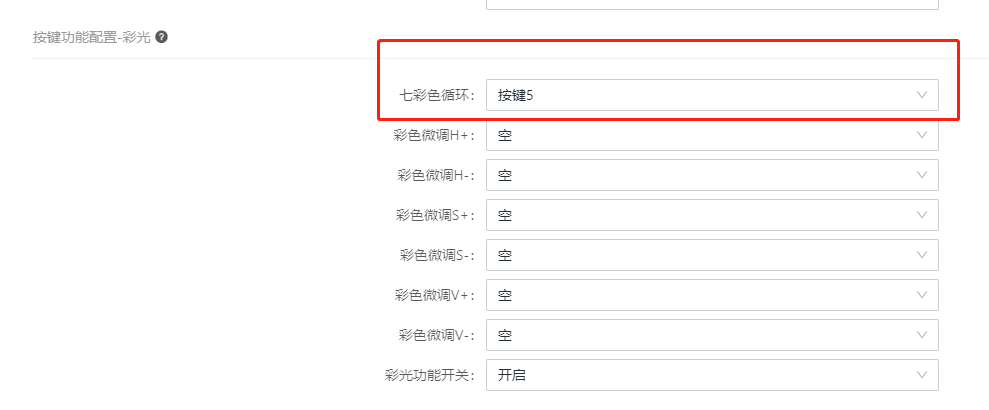

如附件 图片 对应免开发遥控器的 七彩色循环功能。

使用标准的sigmesh opcode
	 R   G   B      H   S   L
红:255  	 0   0      0  100  50
橙:255 97 0 23 100 50 黄:255 255 0 60 100 50 绿: 0 255 0 120 100 50 青: 0 255 255 180 100 50 蓝: 0 0 255 240 100 50 紫:128 0 128 300 100 25 */ int mesh_light_color_set(u16 sub_addr,u8 color,u8 lum_per) { mesh_cmd_light_hsl_set_t hsl; switch(color){ case 0 : hsl.hue = 0; hsl.sat = 65535*100/100; hsl.lightness = 65535*50/100; break; case 1 : hsl.hue = 65535*23/360; hsl.sat = 65535*100/100; hsl.lightness = 65535*50/100; break; case 2 : hsl.hue = 65535*60/360; hsl.sat = 65535*100/100; hsl.lightness = 65535*50/100; break; case 3 : hsl.hue = 65535*120/360; hsl.sat = 65535*100/100; hsl.lightness = 65535*50/100; break; case 4 : hsl.hue = 65535*180/360; hsl.sat = 65535*100/100; hsl.lightness = 65535*50/100; break; case 5 : hsl.hue = 65535*240/360; hsl.sat = 65535*100/100; hsl.lightness = 65535*50/100; break; case 6 : hsl.hue = 65535*300/360; hsl.sat = 65535*100/100; hsl.lightness = 65535*25/100; break; default : hsl.hue = 0; hsl.sat = 0; hsl.lightness = 0; break; } hsl.lightness = 65535*lum_per/2/100; hsl.tid = ++mesh_tid.tx[0]; analog_write(REGA_TID, mesh_tid.tx[0]); return mesh_tx_cmd2normal_primary(LIGHT_HSL_SET_NOACK, (u8*)&hsl, 7, sub_addr,0); }
