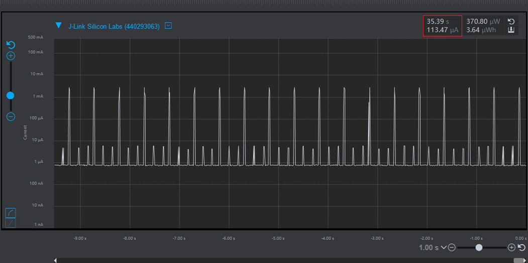

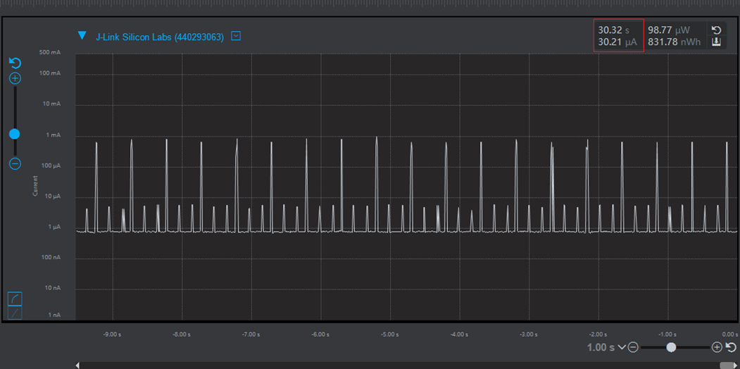

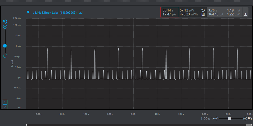

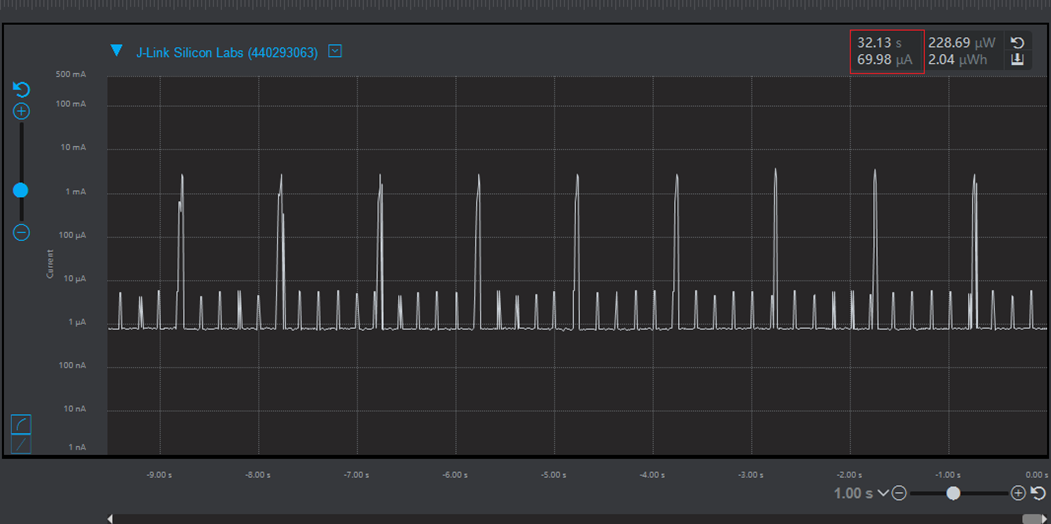

广播间隔(ms)idle301002005001000
平均电流(uA)0.97414.9138.973.530.217.7

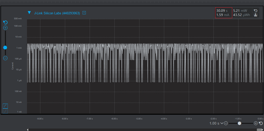

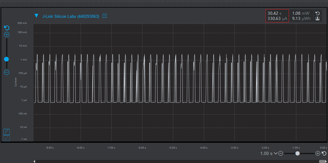

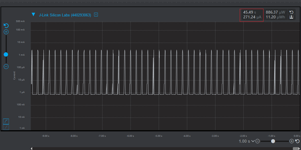

扩展广播间隔(ms)301002005001000
平均电流(uA)1590530.4271.2113.555.5

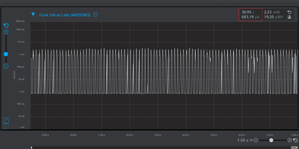

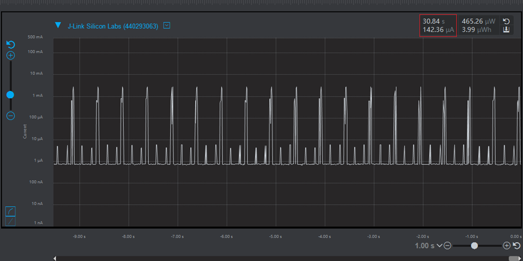

两路广播间隔(ms)301002005001000
平均电流(uA)1950683.2330.6142.470.0

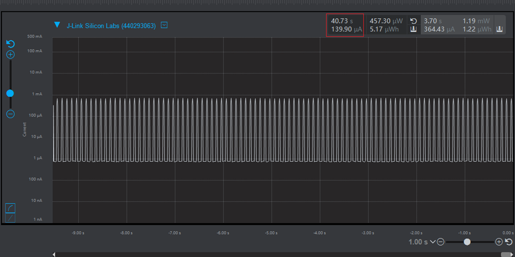

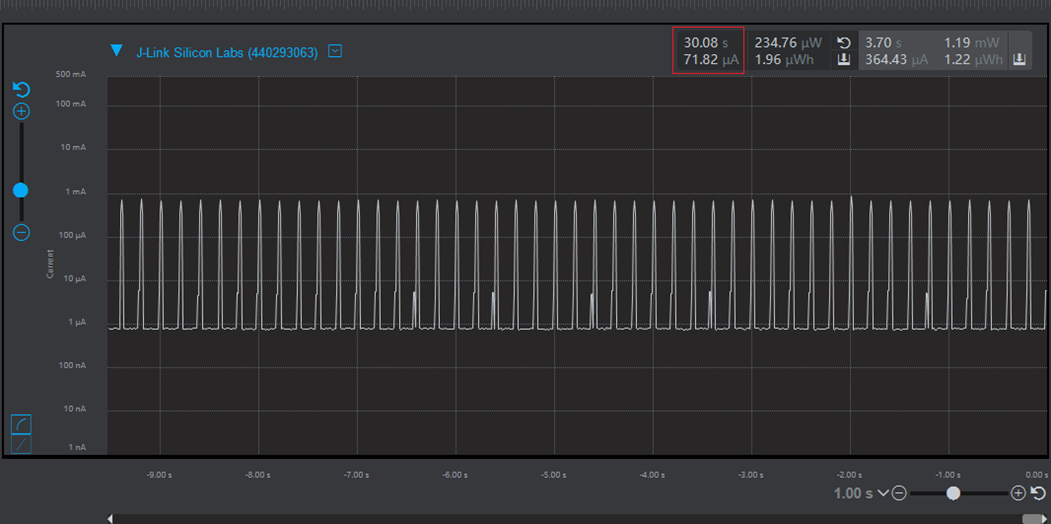

连接间隔(ms)idle301002005001000
平均电流(uA)/467.6139.971.829.717.5
