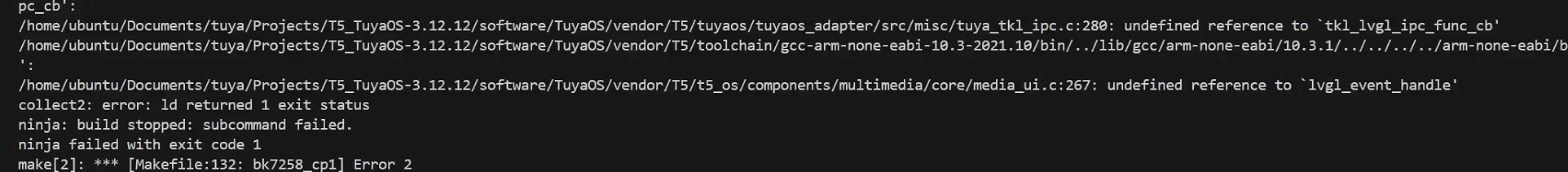

如图所示,在编译时提示LVGL相关函数未定义,项目未使用LVGL库,应该如何屏蔽此部分让未使用的LVGL部分不参与编译

Re: T5 TuyaOS_3.12.12编译报错未定义函数

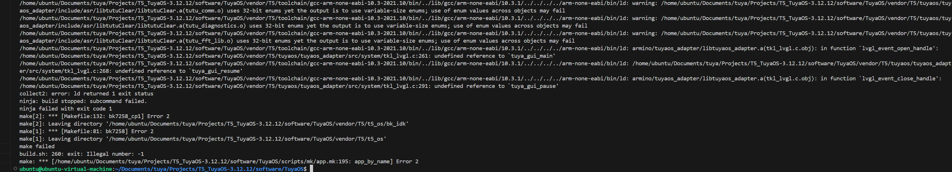

我是在3.12.12内新建了一个项目,并没有使用tuyaos_demo_ai_toy这个demo,新建的项目未使用lvgl相关接口,然后它在编译时出现了LVGL相关的错误,如下图,我应该怎样解决这个问题,工程在之前的3.12.11版本sdk上面是可以正常编译的,更新到.12之后出现的这个问题
完整的log如下

make[1]: Entering directory '/home/ubuntu/Documents/tuya/Projects/T5_TuyaOS-3.12.12/software/TuyaOS/vendor/T5/t5_os'
ARMINO_SOC is set to bk7258
ARMINO_TARGET is set to build
armino project path=../projects/tuya_app
armino path=/home/ubuntu/Documents/tuya/Projects/T5_TuyaOS-3.12.12/software/TuyaOS/vendor/T5/t5_os/bk_idk
armino build path=../build
make[2]: Entering directory '/home/ubuntu/Documents/tuya/Projects/T5_TuyaOS-3.12.12/software/TuyaOS/vendor/T5/t5_os/bk_idk'
Parsing CSV input to gen part table...
Remap part table, convert logic addr to phy addr...
make[2]: Circular bk7258_cp1 <- bk7258_cp1 dependency dropped.
Gen partition_bk7256_ota_a_new.json using remapped part table...
 build T5_CPU1
Setting ARMINO_PATH environment variable: /home/ubuntu/Documents/tuya/Projects/T5_TuyaOS-3.12.12/software/TuyaOS/vendor/T5/t5_os/bk_idk
/home/ubuntu/Documents/tuya/Projects/T5_TuyaOS-3.12.12/software/TuyaOS/vendor/T5/t5_os/bk_idk/tools/build_tools/check_python_dependencies.py:9: DeprecationWarning: pkg_resources is deprecated as an API. See https://setuptools.pypa.io/en/latest/pkg_resources.html
  import pkg_resources
Executing action: set-target
Target is same as cached target, not full clean
Done
Executing action: all (aliases: build)
Running ninja in directory /home/ubuntu/Documents/tuya/Projects/T5_TuyaOS-3.12.12/software/TuyaOS/vendor/T5/t5_os/build/bk7258_cp1
Executing "ninja all"...
[0/1] Re-running CMake...
-- LIB_HASH IS "79f4e8af28d6bfdf65f9f232c9032f40"
-- use configured toolchain path: ../../toolchain/gcc-arm-none-eabi-10.3-2021.10/bin
-- global toolchain file: /home/ubuntu/Documents/tuya/Projects/T5_TuyaOS-3.12.12/software/TuyaOS/vendor/T5/t5_os/bk_idk/middleware/soc/bk7258_cp1/toolchain-bk7258_cp1.cmake
-- Project is not inside a git repository, or git repository has no commits;
-- Building Beken ARMINO components for target bk7258_cp1
-- --------------- bk lwip ---------------
/home/ubuntu/Documents/tuya/Projects/T5_TuyaOS-3.12.12/software/TuyaOS/vendor/T5/t5_os/build/bk7258_cp1/kconfigs.in
/home/ubuntu/Documents/tuya/Projects/T5_TuyaOS-3.12.12/software/TuyaOS/vendor/T5/t5_os/build/bk7258_cp1/components_kconfigs.in
/home/ubuntu/Documents/tuya/Projects/T5_TuyaOS-3.12.12/software/TuyaOS/vendor/T5/t5_os/build/bk7258_cp1/middleware_kconfigs.in
/home/ubuntu/Documents/tuya/Projects/T5_TuyaOS-3.12.12/software/TuyaOS/vendor/T5/t5_os/build/bk7258_cp1/projects_kconfigs.in
/home/ubuntu/Documents/tuya/Projects/T5_TuyaOS-3.12.12/software/TuyaOS/vendor/T5/t5_os/build/bk7258_cp1/properties_kconfigs.in
/home/ubuntu/Documents/tuya/Projects/T5_TuyaOS-3.12.12/software/TuyaOS/vendor/T5/t5_os/build/bk7258_cp1/extra_kconfigs.in
warning: ASDF_AUTO_TEST_PIPELINE (defined at /home/ubuntu/Documents/tuya/Projects/T5_TuyaOS-3.12.12/software/TuyaOS/vendor/T5/t5_os/components/bk_audio/audio_pipeline/Kconfig:27) has leading or trailing whitespace in its prompt
warning: ASDF_AUTO_TEST_ELEMENT (defined at /home/ubuntu/Documents/tuya/Projects/T5_TuyaOS-3.12.12/software/TuyaOS/vendor/T5/t5_os/components/bk_audio/audio_pipeline/Kconfig:32) has leading or trailing whitespace in its prompt
warning: ASDF_AUTO_TEST_EVENT (defined at /home/ubuntu/Documents/tuya/Projects/T5_TuyaOS-3.12.12/software/TuyaOS/vendor/T5/t5_os/components/bk_audio/audio_pipeline/Kconfig:37) has leading or trailing whitespace in its prompt
warning: AUD_TRAS_UAC_SPK_VOL_CTRL_MODE_STOP_UAC_TRAS (defined at /home/ubuntu/Documents/tuya/Projects/T5_TuyaOS-3.12.12/software/TuyaOS/vendor/T5/t5_os/components/codec/legacy/media/audio/aud_intf/Kconfig:161) has leading or trailing whitespace in its prompt
warning: AUD_TRAS_UAC_SPK_VOL_CTRL_MODE_MUTE (defined at /home/ubuntu/Documents/tuya/Projects/T5_TuyaOS-3.12.12/software/TuyaOS/vendor/T5/t5_os/components/codec/legacy/media/audio/aud_intf/Kconfig:166) has leading or trailing whitespace in its prompt
warning: DMA_LOGIC_CHAN_CNT (defined at /home/ubuntu/Documents/tuya/Projects/T5_TuyaOS-3.12.12/software/TuyaOS/vendor/T5/t5_os/bk_idk/middleware/driver/general_dma/Kconfig:19) defined with multiple prompts in single location
warning: DMA_LOGIC_CHAN_ID_MIN (defined at /home/ubuntu/Documents/tuya/Projects/T5_TuyaOS-3.12.12/software/TuyaOS/vendor/T5/t5_os/bk_idk/middleware/driver/general_dma/Kconfig:26) defined with multiple prompts in single location
warning: DIGLDO_LOW_VOLTAGE_ENABLE (defined at /home/ubuntu/Documents/tuya/Projects/T5_TuyaOS-3.12.12/software/TuyaOS/vendor/T5/t5_os/bk_idk/middleware/driver/pwr_clk/Kconfig:61) has leading or trailing whitespace in its prompt
warning: default on the choice symbol GDMA_HW_V2PX (defined at /home/ubuntu/Documents/tuya/Projects/T5_TuyaOS-3.12.12/software/TuyaOS/vendor/T5/t5_os/bk_idk/middleware/driver/general_dma/Kconfig:10) will have no effect, as defaults do not affect choice symbols
warning: default on the choice symbol GDMA_HW_V1PX (defined at /home/ubuntu/Documents/tuya/Projects/T5_TuyaOS-3.12.12/software/TuyaOS/vendor/T5/t5_os/bk_idk/middleware/driver/general_dma/Kconfig:14) will have no effect, as defaults do not affect choice symbols
warning: the value 'n' is invalid for ENABLE_TUYA_LVGL_TEST_DEMO (defined at /home/ubuntu/Documents/tuya/Projects/T5_TuyaOS-3.12.12/software/TuyaOS/vendor/T5/tuyaos/tuyaos_adapter/Kconfig:84), which has type int -- assignment ignored
warning: The int symbol UART_ATE_PORT (defined at /home/ubuntu/Documents/tuya/Projects/T5_TuyaOS-3.12.12/software/TuyaOS/vendor/T5/t5_os/bk_idk/middleware/driver/uart/Kconfig:31) is being evaluated in a logical context somewhere. It will always evaluate to n.
Loading defaults file /home/ubuntu/Documents/tuya/Projects/T5_TuyaOS-3.12.12/software/TuyaOS/vendor/T5/t5_os/bk_idk/middleware/soc/bk7258_cp1/bk7258_cp1.defconfig...
Loading defaults file /home/ubuntu/Documents/tuya/Projects/T5_TuyaOS-3.12.12/software/TuyaOS/vendor/T5/t5_os/projects/tuya_app/config/bk7258_cp1/config...
-- check_security_firmware_tool = /home/ubuntu/Documents/tuya/Projects/T5_TuyaOS-3.12.12/software/TuyaOS/vendor/T5/t5_os/bk_idk/tools/build_tools/check_security_firmware.py
-- main_target_path = /home/ubuntu/Documents/tuya/Projects/T5_TuyaOS-3.12.12/software/TuyaOS/vendor/T5/t5_os/projects/tuya_app/config/bk7258
-- smode_inseqs_tool execute success...
-- Include directory '/home/ubuntu/Documents/tuya/Projects/T5_TuyaOS-3.12.12/software/TuyaOS/vendor/T5/t5_os/bk_idk/components/wpa_supplicant-2.10/include/bk_private' is not a directory.
-- bk_libs and toolchain version verify success...
-- Include directory '/home/ubuntu/Documents/tuya/Projects/T5_TuyaOS-3.12.12/software/TuyaOS/vendor/T5/t5_os/components/avdk_libs/include' is not a directory.
-- Include directory '/home/ubuntu/Documents/tuya/Projects/T5_TuyaOS-3.12.12/software/TuyaOS/vendor/T5/tuyaos/tuyaos_adapter/include/tal_compatible' is not a directory.
-- Include directory '/home/ubuntu/Documents/tuya/Projects/T5_TuyaOS-3.12.12/software/TuyaOS/vendor/T5/tuyaos/tuyaos_adapter/include/asr/bat_asr' is not a directory.
-- Include directory '/home/ubuntu/Documents/tuya/Projects/T5_TuyaOS-3.12.12/software/TuyaOS/include/components/lib_tflm' is not a directory.
-- [Select ld file]: /home/ubuntu/Documents/tuya/Projects/T5_TuyaOS-3.12.12/software/TuyaOS/vendor/T5/t5_os/bk_idk/middleware/soc/bk7258_cp1/bk7258_cp1_bsp.ld.
-- Adding linker script /home/ubuntu/Documents/tuya/Projects/T5_TuyaOS-3.12.12/software/TuyaOS/vendor/T5/t5_os/build/bk7258_cp1/armino/bk7258_cp1/bk7258_cp1_out.ld
-- Include directory '/home/ubuntu/Documents/tuya/Projects/T5_TuyaOS-3.12.12/software/TuyaOS/vendor/T5/t5_os/bk_idk/components/bk_pm/include' is not a directory.
Found User C Module(s):
-- Include directory '/home/ubuntu/Documents/tuya/Projects/T5_TuyaOS-3.12.12/software/TuyaOS/vendor/T5/t5_os/projects/tuya_app/main/include' is not a directory.
-- Include directory '/home/ubuntu/Documents/tuya/Projects/T5_TuyaOS-3.12.12/software/TuyaOS/adapter/utilities/include' is not a directory.
Check defconfig: /home/ubuntu/Documents/tuya/Projects/T5_TuyaOS-3.12.12/software/TuyaOS/vendor/T5/t5_os/bk_idk/middleware/soc/bk7258_cp1/bk7258_cp1.defconfig
-- Components: aac_decoder adc_key agora-iot-sdk ali_mqtt app arm9 at at_server aud_intf audio_pipeline audio_play audio_record avdk_libs base64 bk7258_cp1 bk_adapter bk_airkiss bk_ate bk_bluetooth bk_cli bk_common bk_draw_blend bk_event bk_httpc bk_https bk_init bk_libs bk_log bk_netif bk_peripheral bk_phy bk_pm bk_ps bk_rtos bk_startup bk_system bk_usb bk_vfs bk_websocket bk_wifi bt cli_test cm33 cmsis common compal compress coredump cs2p2p display_service dma2d doorbell driver easy_flash eez-framework embeded_gcov face_detection fatfs fatfs_stream flashdb freetype hmac_sha_256 http image_convert include iperf jpeg_encoder jrtplib json key key_handle littlefs lvgl lwip_intf_v2_1 main mbedtls media media_service media_unit_test media_utils mesh micropython multimedia net_transfer onboard_mic_stream onboard_speaker_stream openssl os os_source ota part_table partitions psa_mbedtls qcbor raw_stream release riscv rott saradc_intf security temp_detect tfm_mbedtls touch tuyaos_adapter uart_debug unity user_driver utf8 video vnd_flash wanson webclient wifi_transfer wolfssl wpa_supplicant-2.10
-- Configuring done
-- Generating done
-- Build files have been written to: /home/ubuntu/Documents/tuya/Projects/T5_TuyaOS-3.12.12/software/TuyaOS/vendor/T5/t5_os/build/bk7258_cp1
[3/5] Linking CXX executable app.elf
FAILED: app.elf
: && /home/ubuntu/Documents/tuya/Projects/T5_TuyaOS-3.12.12/software/TuyaOS/vendor/T5/t5_os/bk_idk/../../toolchain/gcc-arm-none-eabi-10.3-2021.10/bin/arm-none-eabi-g++ -mcpu=cortex-m33+nodsp -mfpu=fpv5-sp-d16 -mfloat-abi=hard -mcmse -DWIFI_BLE_COEXIST -DCONFIG_CMAKE=1 -DBK_MAC=1 -Wl,--gc-sections -nostdlib -Wl,-wrap,malloc -Wl,-wrap,_malloc_r -Wl,-wrap,free -Wl,-wrap,_free_r -Wl,-wrap,zalloc -Wl,-wrap,calloc -Wl,-wrap,realloc  -Wl,-wrap,_realloc_r -Wl,-wrap,printf -Wl,-wrap,vsnprintf -Wl,-wrap,snprintf -Wl,-wrap,sprintf -Wl,-wrap,puts -Wl,-wrap,__assert_func  CMakeFiles/app.elf.dir/project_elf_src.c.obj -o app.elf  -lm  -lgcc  -lc  -lnosys  -Wl,--start-group  -lstdc++  armino/bk_log/libbk_log.a  armino/utf8/libutf8.a  armino/temp_detect/libtemp_detect.a  armino/bk_rtos/libbk_rtos.a  armino/os_source/libos_source.a  armino/coredump/libcoredump.a  armino/cmsis/libcmsis.a  armino/cm33/libcm33.a  armino/bk_phy/libbk_phy.a  armino/bk_ate/libbk_ate.a  armino/base64/libbase64.a  armino/driver/libdriver.a  armino/lwip_intf_v2_1/liblwip_intf_v2_1.a  armino/bk_adapter/libbk_adapter.a  armino/bk_wifi/libbk_wifi.a  armino/littlefs/liblittlefs.a  armino/app/libapp.a  armino/bk_system/libbk_system.a  armino/bk_usb/libbk_usb.a  armino/fatfs/libfatfs.a  armino/bk_init/libbk_init.a  armino/unity/libunity.a  armino/ota/libota.a  armino/bk_vfs/libbk_vfs.a  armino/bk_cli/libbk_cli.a  armino/freetype/libfreetype.a  armino/bk_peripheral/libbk_peripheral.a  armino/bk_draw_blend/libbk_draw_blend.a  armino/display_service/libdisplay_service.a  armino/lvgl/liblvgl.a  armino/face_detection/libface_detection.a  armino/video/libvideo.a  armino/media_utils/libmedia_utils.a  armino/multimedia/libmultimedia.a  armino/media_service/libmedia_service.a  armino/tuyaos_adapter/libtuyaos_adapter.a  armino/bk7258_cp1/libbk7258_cp1.a  armino/common/libcommon.a  armino/bk_startup/libbk_startup.a  armino/bk_event/libbk_event.a  armino/bk_common/libbk_common.a  armino/bk_pm/libbk_pm.a  armino/compress/libcompress.a  armino/hmac_sha_256/libhmac_sha_256.a  armino/qcbor/libqcbor.a  armino/security/libsecurity.a  armino/eez-framework/libeez-framework.a  armino/image_convert/libimage_convert.a  armino/main/libmain.a  -Wl,--cref -Wl,--Map=/home/ubuntu/Documents/tuya/Projects/T5_TuyaOS-3.12.12/software/TuyaOS/vendor/T5/t5_os/build/bk7258_cp1/app.map  -fno-rtti  -fno-lto  /home/ubuntu/Documents/tuya/Projects/T5_TuyaOS-3.12.12/software/TuyaOS/vendor/T5/t5_os/components/avdk_libs/bk7258_cp1/libs/libscale_dtcm.a  /home/ubuntu/Documents/tuya/Projects/T5_TuyaOS-3.12.12/software/TuyaOS/vendor/T5/t5_os/components/avdk_libs/bk7258_cp1/libs/libtjpg_dtcm_part.a  armino/bk_log/libbk_log.a  armino/utf8/libutf8.a  armino/temp_detect/libtemp_detect.a  armino/bk_rtos/libbk_rtos.a  armino/os_source/libos_source.a  armino/coredump/libcoredump.a  armino/cmsis/libcmsis.a  armino/cm33/libcm33.a  armino/bk_phy/libbk_phy.a  armino/bk_ate/libbk_ate.a  armino/base64/libbase64.a  armino/driver/libdriver.a  armino/lwip_intf_v2_1/liblwip_intf_v2_1.a  armino/bk_wifi/libbk_wifi.a  armino/littlefs/liblittlefs.a  armino/app/libapp.a  armino/bk_system/libbk_system.a  armino/bk_usb/libbk_usb.a  armino/fatfs/libfatfs.a  armino/bk_init/libbk_init.a  armino/unity/libunity.a  armino/ota/libota.a  armino/bk_vfs/libbk_vfs.a  armino/bk_cli/libbk_cli.a  armino/freetype/libfreetype.a  armino/bk_peripheral/libbk_peripheral.a  armino/bk_draw_blend/libbk_draw_blend.a  armino/display_service/libdisplay_service.a  armino/lvgl/liblvgl.a  armino/video/libvideo.a  armino/media_utils/libmedia_utils.a  armino/multimedia/libmultimedia.a  armino/media_service/libmedia_service.a  armino/tuyaos_adapter/libtuyaos_adapter.a  armino/bk7258_cp1/libbk7258_cp1.a  armino/common/libcommon.a  armino/bk_startup/libbk_startup.a  armino/bk_event/libbk_event.a  armino/bk_common/libbk_common.a  armino/bk_log/libbk_log.a  armino/utf8/libutf8.a  armino/temp_detect/libtemp_detect.a  armino/bk_rtos/libbk_rtos.a  armino/os_source/libos_source.a  armino/coredump/libcoredump.a  armino/cmsis/libcmsis.a  armino/cm33/libcm33.a  armino/bk_phy/libbk_phy.a  armino/bk_ate/libbk_ate.a  armino/base64/libbase64.a  armino/driver/libdriver.a  armino/lwip_intf_v2_1/liblwip_intf_v2_1.a  armino/bk_wifi/libbk_wifi.a  armino/littlefs/liblittlefs.a  armino/app/libapp.a  armino/bk_system/libbk_system.a  armino/bk_usb/libbk_usb.a  armino/fatfs/libfatfs.a  armino/bk_init/libbk_init.a  armino/unity/libunity.a  armino/ota/libota.a  armino/bk_vfs/libbk_vfs.a  armino/bk_cli/libbk_cli.a  armino/freetype/libfreetype.a  armino/bk_peripheral/libbk_peripheral.a  armino/bk_draw_blend/libbk_draw_blend.a  armino/display_service/libdisplay_service.a  armino/lvgl/liblvgl.a  armino/video/libvideo.a  armino/media_utils/libmedia_utils.a  armino/multimedia/libmultimedia.a  armino/media_service/libmedia_service.a  armino/tuyaos_adapter/libtuyaos_adapter.a  armino/bk7258_cp1/libbk7258_cp1.a  armino/common/libcommon.a  armino/bk_startup/libbk_startup.a  armino/bk_event/libbk_event.a  armino/bk_common/libbk_common.a  /home/ubuntu/Documents/tuya/Projects/T5_TuyaOS-3.12.12/software/TuyaOS/vendor/T5/t5_os/bk_idk/components/bk_libs/bk7258_cp1/libs/libbk_phy.a  /home/ubuntu/Documents/tuya/Projects/T5_TuyaOS-3.12.12/software/TuyaOS/vendor/T5/t5_os/bk_idk/components/bk_libs/bk7258_cp1/libs/libusb.a  /home/ubuntu/Documents/tuya/Projects/T5_TuyaOS-3.12.12/software/TuyaOS/vendor/T5/t5_os/components/avdk_libs/bk7258_cp1/libs/libaacdec.a  /home/ubuntu/Documents/tuya/Projects/T5_TuyaOS-3.12.12/software/TuyaOS/vendor/T5/t5_os/components/avdk_libs/bk7258_cp1/libs/libadpcm.a  /home/ubuntu/Documents/tuya/Projects/T5_TuyaOS-3.12.12/software/TuyaOS/vendor/T5/t5_os/components/avdk_libs/bk7258_cp1/libs/libaec.a  /home/ubuntu/Documents/tuya/Projects/T5_TuyaOS-3.12.12/software/TuyaOS/vendor/T5/t5_os/components/avdk_libs/bk7258_cp1/libs/libagc.a  /home/ubuntu/Documents/tuya/Projects/T5_TuyaOS-3.12.12/software/TuyaOS/vendor/T5/t5_os/components/avdk_libs/bk7258_cp1/libs/libaud_ns.a  /home/ubuntu/Documents/tuya/Projects/T5_TuyaOS-3.12.12/software/TuyaOS/vendor/T5/t5_os/components/avdk_libs/bk7258_cp1/libs/libaud_vad.a  /home/ubuntu/Documents/tuya/Projects/T5_TuyaOS-3.12.12/software/TuyaOS/vendor/T5/t5_os/components/avdk_libs/bk7258_cp1/libs/libaudio_osi.a  /home/ubuntu/Documents/tuya/Projects/T5_TuyaOS-3.12.12/software/TuyaOS/vendor/T5/t5_os/components/avdk_libs/bk7258_cp1/libs/libavi.a  /home/ubuntu/Documents/tuya/Projects/T5_TuyaOS-3.12.12/software/TuyaOS/vendor/T5/t5_os/components/avdk_libs/bk7258_cp1/libs/libflac.a  /home/ubuntu/Documents/tuya/Projects/T5_TuyaOS-3.12.12/software/TuyaOS/vendor/T5/t5_os/components/avdk_libs/bk7258_cp1/libs/libfreetype.a  /home/ubuntu/Documents/tuya/Projects/T5_TuyaOS-3.12.12/software/TuyaOS/vendor/T5/t5_os/components/avdk_libs/bk7258_cp1/libs/libg711.a  /home/ubuntu/Documents/tuya/Projects/T5_TuyaOS-3.12.12/software/TuyaOS/vendor/T5/t5_os/components/avdk_libs/bk7258_cp1/libs/libhelix.a  /home/ubuntu/Documents/tuya/Projects/T5_TuyaOS-3.12.12/software/TuyaOS/vendor/T5/t5_os/components/avdk_libs/bk7258_cp1/libs/liblcd_font.a  /home/ubuntu/Documents/tuya/Projects/T5_TuyaOS-3.12.12/software/TuyaOS/vendor/T5/t5_os/components/avdk_libs/bk7258_cp1/libs/liblibjpeg.a  /home/ubuntu/Documents/tuya/Projects/T5_TuyaOS-3.12.12/software/TuyaOS/vendor/T5/t5_os/components/avdk_libs/bk7258_cp1/libs/libogg.a  /home/ubuntu/Documents/tuya/Projects/T5_TuyaOS-3.12.12/software/TuyaOS/vendor/T5/t5_os/components/avdk_libs/bk7258_cp1/libs/libopus.a  /home/ubuntu/Documents/tuya/Projects/T5_TuyaOS-3.12.12/software/TuyaOS/vendor/T5/t5_os/components/avdk_libs/bk7258_cp1/libs/libqrcodegen.a  /home/ubuntu/Documents/tuya/Projects/T5_TuyaOS-3.12.12/software/TuyaOS/vendor/T5/t5_os/components/avdk_libs/bk7258_cp1/libs/libresample.a  /home/ubuntu/Documents/tuya/Projects/T5_TuyaOS-3.12.12/software/TuyaOS/vendor/T5/t5_os/components/avdk_libs/bk7258_cp1/libs/libsbc.a  /home/ubuntu/Documents/tuya/Projects/T5_TuyaOS-3.12.12/software/TuyaOS/vendor/T5/t5_os/components/avdk_libs/bk7258_cp1/libs/libvideo_osi.a  /home/ubuntu/Documents/tuya/Projects/T5_TuyaOS-3.12.12/software/TuyaOS/vendor/T5/t5_os/components/avdk_libs/bk7258_cp1/libs/libwav.a  -Wl,--whole-archive  /home/ubuntu/Documents/tuya/Projects/T5_TuyaOS-3.12.12/software/TuyaOS/libs/libE_Frame_T5.a  -Wl,--no-whole-archive  /home/ubuntu/Documents/tuya/Projects/T5_TuyaOS-3.12.12/software/TuyaOS/libs/libtuyaapp_drivers.a  /home/ubuntu/Documents/tuya/Projects/T5_TuyaOS-3.12.12/software/TuyaOS/libs/libtuyaapp_components.a  /home/ubuntu/Documents/tuya/Projects/T5_TuyaOS-3.12.12/software/TuyaOS/libs/libtuyaos.a  /home/ubuntu/Documents/tuya/Projects/T5_TuyaOS-3.12.12/software/TuyaOS/vendor/T5/tuyaos/tuyaos_adapter/include/vad/lib/libvad.a  /home/ubuntu/Documents/tuya/Projects/T5_TuyaOS-3.12.12/software/TuyaOS/vendor/T5/tuyaos/tuyaos_adapter/include/asr/wanson_asr/libasrfst.a  /home/ubuntu/Documents/tuya/Projects/T5_TuyaOS-3.12.12/software/TuyaOS/vendor/T5/tuyaos/tuyaos_adapter/include/asr/libtutuClear/libtutuClear.a  -L /home/ubuntu/Documents/tuya/Projects/T5_TuyaOS-3.12.12/software/TuyaOS/vendor/T5/t5_os/build/bk7258_cp1/armino/bk7258_cp1  -T bk7258_cp1_out.ld  -lm  -lgcc  -lc  -lnosys && :
/home/ubuntu/Documents/tuya/Projects/T5_TuyaOS-3.12.12/software/TuyaOS/vendor/T5/toolchain/gcc-arm-none-eabi-10.3-2021.10/bin/../lib/gcc/arm-none-eabi/10.3.1/../../../../arm-none-eabi/bin/ld: missing --end-group; added as last command line option
/home/ubuntu/Documents/tuya/Projects/T5_TuyaOS-3.12.12/software/TuyaOS/vendor/T5/toolchain/gcc-arm-none-eabi-10.3-2021.10/bin/../lib/gcc/arm-none-eabi/10.3.1/../../../../arm-none-eabi/bin/ld: warning: /home/ubuntu/Documents/tuya/Projects/T5_TuyaOS-3.12.12/software/TuyaOS/vendor/T5/tuyaos/tuyaos_adapter/include/asr/libtutuClear/libtutuClear.a(tutuClear.o) uses 32-bit enums yet the output is to use variable-size enums; use of enum values across objects may fail
/home/ubuntu/Documents/tuya/Projects/T5_TuyaOS-3.12.12/software/TuyaOS/vendor/T5/toolchain/gcc-arm-none-eabi-10.3-2021.10/bin/../lib/gcc/arm-none-eabi/10.3.1/../../../../arm-none-eabi/bin/ld: warning: /home/ubuntu/Documents/tuya/Projects/T5_TuyaOS-3.12.12/software/TuyaOS/vendor/T5/tuyaos/tuyaos_adapter/include/asr/libtutuClear/libtutuClear.a(tutuLrn.o) uses 32-bit enums yet the output is to use variable-size enums; use of enum values across objects may fail
/home/ubuntu/Documents/tuya/Projects/T5_TuyaOS-3.12.12/software/TuyaOS/vendor/T5/toolchain/gcc-arm-none-eabi-10.3-2021.10/bin/../lib/gcc/arm-none-eabi/10.3.1/../../../../arm-none-eabi/bin/ld: warning: /home/ubuntu/Documents/tuya/Projects/T5_TuyaOS-3.12.12/software/TuyaOS/vendor/T5/tuyaos/tuyaos_adapter/include/asr/libtutuClear/libtutuClear.a(tutu_constvar.o) uses 32-bit enums yet the output is to use variable-size enums; use of enum values across objects may fail
/home/ubuntu/Documents/tuya/Projects/T5_TuyaOS-3.12.12/software/TuyaOS/vendor/T5/toolchain/gcc-arm-none-eabi-10.3-2021.10/bin/../lib/gcc/arm-none-eabi/10.3.1/../../../../arm-none-eabi/bin/ld: warning: /home/ubuntu/Documents/tuya/Projects/T5_TuyaOS-3.12.12/software/TuyaOS/vendor/T5/tuyaos/tuyaos_adapter/include/asr/libtutuClear/libtutuClear.a(tutu_core.o) uses 32-bit enums yet the output is to use variable-size enums; use of enum values across objects may fail
/home/ubuntu/Documents/tuya/Projects/T5_TuyaOS-3.12.12/software/TuyaOS/vendor/T5/toolchain/gcc-arm-none-eabi-10.3-2021.10/bin/../lib/gcc/arm-none-eabi/10.3.1/../../../../arm-none-eabi/bin/ld: warning: /home/ubuntu/Documents/tuya/Projects/T5_TuyaOS-3.12.12/software/TuyaOS/vendor/T5/tuyaos/tuyaos_adapter/include/asr/libtutuClear/libtutuClear.a(tutu_ctrl.o) uses 32-bit enums yet the output is to use variable-size enums; use of enum values across objects may fail
/home/ubuntu/Documents/tuya/Projects/T5_TuyaOS-3.12.12/software/TuyaOS/vendor/T5/toolchain/gcc-arm-none-eabi-10.3-2021.10/bin/../lib/gcc/arm-none-eabi/10.3.1/../../../../arm-none-eabi/bin/ld: warning: /home/ubuntu/Documents/tuya/Projects/T5_TuyaOS-3.12.12/software/TuyaOS/vendor/T5/tuyaos/tuyaos_adapter/include/asr/libtutuClear/libtutuClear.a(tutu_init.o) uses 32-bit enums yet the output is to use variable-size enums; use of enum values across objects may fail
/home/ubuntu/Documents/tuya/Projects/T5_TuyaOS-3.12.12/software/TuyaOS/vendor/T5/toolchain/gcc-arm-none-eabi-10.3-2021.10/bin/../lib/gcc/arm-none-eabi/10.3.1/../../../../arm-none-eabi/bin/ld: warning: /home/ubuntu/Documents/tuya/Projects/T5_TuyaOS-3.12.12/software/TuyaOS/vendor/T5/tuyaos/tuyaos_adapter/include/asr/libtutuClear/libtutuClear.a(tutu_memctrl.o) uses 32-bit enums yet the output is to use variable-size enums; use of enum values across objects may fail
/home/ubuntu/Documents/tuya/Projects/T5_TuyaOS-3.12.12/software/TuyaOS/vendor/T5/toolchain/gcc-arm-none-eabi-10.3-2021.10/bin/../lib/gcc/arm-none-eabi/10.3.1/../../../../arm-none-eabi/bin/ld: warning: /home/ubuntu/Documents/tuya/Projects/T5_TuyaOS-3.12.12/software/TuyaOS/vendor/T5/tuyaos/tuyaos_adapter/include/asr/libtutuClear/libtutuClear.a(tutu_pflpop.o) uses 32-bit enums yet the output is to use variable-size enums; use of enum values across objects may fail
/home/ubuntu/Documents/tuya/Projects/T5_TuyaOS-3.12.12/software/TuyaOS/vendor/T5/toolchain/gcc-arm-none-eabi-10.3-2021.10/bin/../lib/gcc/arm-none-eabi/10.3.1/../../../../arm-none-eabi/bin/ld: warning: /home/ubuntu/Documents/tuya/Projects/T5_TuyaOS-3.12.12/software/TuyaOS/vendor/T5/tuyaos/tuyaos_adapter/include/asr/libtutuClear/libtutuClear.a(tutu_preproc.o) uses 32-bit enums yet the output is to use variable-size enums; use of enum values across objects may fail
/home/ubuntu/Documents/tuya/Projects/T5_TuyaOS-3.12.12/software/TuyaOS/vendor/T5/toolchain/gcc-arm-none-eabi-10.3-2021.10/bin/../lib/gcc/arm-none-eabi/10.3.1/../../../../arm-none-eabi/bin/ld: warning: /home/ubuntu/Documents/tuya/Projects/T5_TuyaOS-3.12.12/software/TuyaOS/vendor/T5/tuyaos/tuyaos_adapter/include/asr/libtutuClear/libtutuClear.a(tutu_t2f.o) uses 32-bit enums yet the output is to use variable-size enums; use of enum values across objects may fail
/home/ubuntu/Documents/tuya/Projects/T5_TuyaOS-3.12.12/software/TuyaOS/vendor/T5/toolchain/gcc-arm-none-eabi-10.3-2021.10/bin/../lib/gcc/arm-none-eabi/10.3.1/../../../../arm-none-eabi/bin/ld: warning: /home/ubuntu/Documents/tuya/Projects/T5_TuyaOS-3.12.12/software/TuyaOS/vendor/T5/tuyaos/tuyaos_adapter/include/asr/libtutuClear/libtutuClear.a(tutu_vtrgr.o) uses 32-bit enums yet the output is to use variable-size enums; use of enum values across objects may fail
/home/ubuntu/Documents/tuya/Projects/T5_TuyaOS-3.12.12/software/TuyaOS/vendor/T5/toolchain/gcc-arm-none-eabi-10.3-2021.10/bin/../lib/gcc/arm-none-eabi/10.3.1/../../../../arm-none-eabi/bin/ld: warning: /home/ubuntu/Documents/tuya/Projects/T5_TuyaOS-3.12.12/software/TuyaOS/vendor/T5/tuyaos/tuyaos_adapter/include/asr/libtutuClear/libtutuClear.a(tutu_basicop.o) uses 32-bit enums yet the output is to use variable-size enums; use of enum values across objects may fail
/home/ubuntu/Documents/tuya/Projects/T5_TuyaOS-3.12.12/software/TuyaOS/vendor/T5/toolchain/gcc-arm-none-eabi-10.3-2021.10/bin/../lib/gcc/arm-none-eabi/10.3.1/../../../../arm-none-eabi/bin/ld: warning: /home/ubuntu/Documents/tuya/Projects/T5_TuyaOS-3.12.12/software/TuyaOS/vendor/T5/tuyaos/tuyaos_adapter/include/asr/libtutuClear/libtutuClear.a(tutu_comm.o) uses 32-bit enums yet the output is to use variable-size enums; use of enum values across objects may fail
/home/ubuntu/Documents/tuya/Projects/T5_TuyaOS-3.12.12/software/TuyaOS/vendor/T5/toolchain/gcc-arm-none-eabi-10.3-2021.10/bin/../lib/gcc/arm-none-eabi/10.3.1/../../../../arm-none-eabi/bin/ld: warning: /home/ubuntu/Documents/tuya/Projects/T5_TuyaOS-3.12.12/software/TuyaOS/vendor/T5/tuyaos/tuyaos_adapter/include/asr/libtutuClear/libtutuClear.a(tutu_diagnostics.o) uses 32-bit enums yet the output is to use variable-size enums; use of enum values across objects may fail
/home/ubuntu/Documents/tuya/Projects/T5_TuyaOS-3.12.12/software/TuyaOS/vendor/T5/toolchain/gcc-arm-none-eabi-10.3-2021.10/bin/../lib/gcc/arm-none-eabi/10.3.1/../../../../arm-none-eabi/bin/ld: warning: /home/ubuntu/Documents/tuya/Projects/T5_TuyaOS-3.12.12/software/TuyaOS/vendor/T5/tuyaos/tuyaos_adapter/include/asr/libtutuClear/libtutuClear.a(tutu_fft_lib.o) uses 32-bit enums yet the output is to use variable-size enums; use of enum values across objects may fail
/home/ubuntu/Documents/tuya/Projects/T5_TuyaOS-3.12.12/software/TuyaOS/vendor/T5/toolchain/gcc-arm-none-eabi-10.3-2021.10/bin/../lib/gcc/arm-none-eabi/10.3.1/../../../../arm-none-eabi/bin/ld: armino/tuyaos_adapter/libtuyaos_adapter.a(tkl_lvgl.c.obj): in function `lvgl_event_open_handle':
/home/ubuntu/Documents/tuya/Projects/T5_TuyaOS-3.12.12/software/TuyaOS/vendor/T5/tuyaos/tuyaos_adapter/src/system/tkl_lvgl.c:261: undefined reference to `tuya_gui_main'
/home/ubuntu/Documents/tuya/Projects/T5_TuyaOS-3.12.12/software/TuyaOS/vendor/T5/toolchain/gcc-arm-none-eabi-10.3-2021.10/bin/../lib/gcc/arm-none-eabi/10.3.1/../../../../arm-none-eabi/bin/ld: /home/ubuntu/Documents/tuya/Projects/T5_TuyaOS-3.12.12/software/TuyaOS/vendor/T5/tuyaos/tuyaos_adapter/src/system/tkl_lvgl.c:268: undefined reference to `tuya_gui_resume'
/home/ubuntu/Documents/tuya/Projects/T5_TuyaOS-3.12.12/software/TuyaOS/vendor/T5/toolchain/gcc-arm-none-eabi-10.3-2021.10/bin/../lib/gcc/arm-none-eabi/10.3.1/../../../../arm-none-eabi/bin/ld: armino/tuyaos_adapter/libtuyaos_adapter.a(tkl_lvgl.c.obj): in function `lvgl_event_close_handle':
/home/ubuntu/Documents/tuya/Projects/T5_TuyaOS-3.12.12/software/TuyaOS/vendor/T5/tuyaos/tuyaos_adapter/src/system/tkl_lvgl.c:291: undefined reference to `tuya_gui_pause'
collect2: error: ld returned 1 exit status
ninja: build stopped: subcommand failed.
ninja failed with exit code 1
make[2]: *** [Makefile:132: bk7258_cp1] Error 2
make[2]: Leaving directory '/home/ubuntu/Documents/tuya/Projects/T5_TuyaOS-3.12.12/software/TuyaOS/vendor/T5/t5_os/bk_idk'
make[1]: *** [Makefile:81: bk7258] Error 2
make[1]: Leaving directory '/home/ubuntu/Documents/tuya/Projects/T5_TuyaOS-3.12.12/software/TuyaOS/vendor/T5/t5_os'
make failed
build.sh: 260: exit: Illegal number: -1
make: *** [/home/ubuntu/Documents/tuya/Projects/T5_TuyaOS-3.12.12/software/TuyaOS/scripts/mk/app.mk:195: app_by_name] Error 2
ubuntu@ubuntu-virtual-machine:~/Documents/tuya/Projects/T5_TuyaOS-3.12.12/software/TuyaOS$
Posts: 953
参考这个:
3, 修改tkl_lvgl.c文件lvgl_event_handle函数,里面的内容注释掉;
或者实现以下那两个找不到的函数,空函数就可以了。
Memory
Posts: 13
谢谢,注释掉后可以正常编译了
