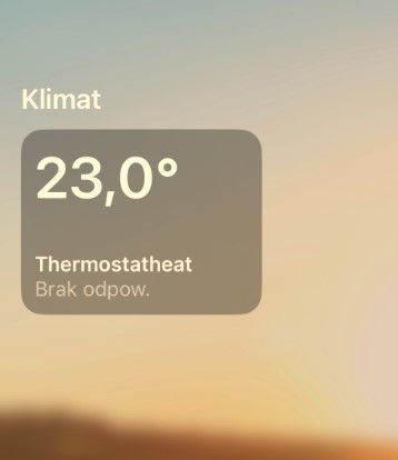

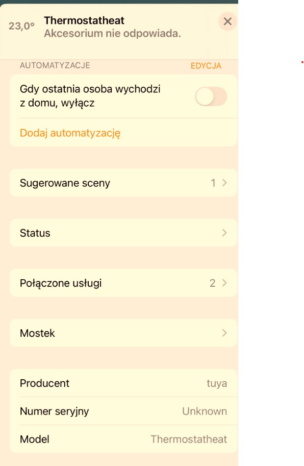

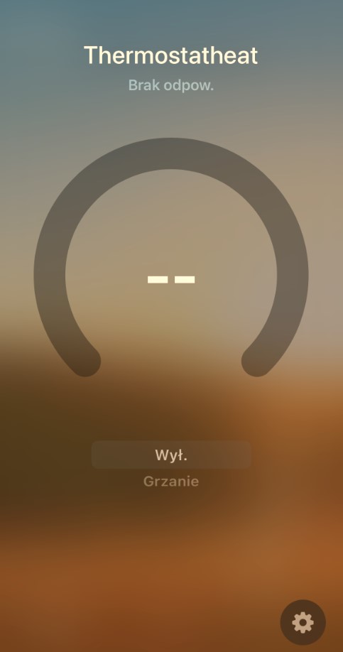

But in Apple HomeKit shows only current temperature from Thermostatic Radiator Valve. I cannot set the desired temperature (manual mode), set the work mode (on/off/manual/auto) or check the battery level. Also the device shows as not responding (On screenshots: "Brak odp." or "Akcesorium nie odpowiada" = "Device is not responding").

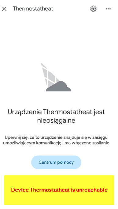

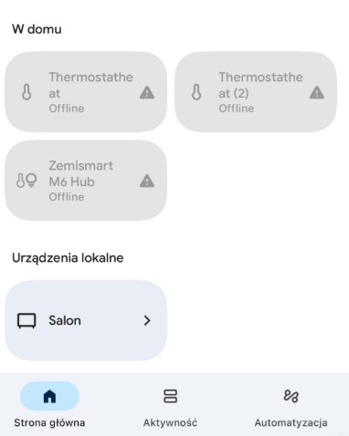

First of all I have tried to bridge device to Google Home (I don't have Home Assistant access at the moment) as you suggested. And the result was even worse as even Zemismart Hub was not responding.

When I first bridge Zemismart Hub with Apple HomeKit and then add sub-device (Thermostatic Radiator Valve) via SmartLife then the result is as described in my first post.
But, when I delete Zemismart Hub from my home in Apple HomeKit, and then readd Zemismart Hub to Apple HomeKit again with subdevice already connected to the hub, then Thermostatic Radiator Valve is working almost as expected.

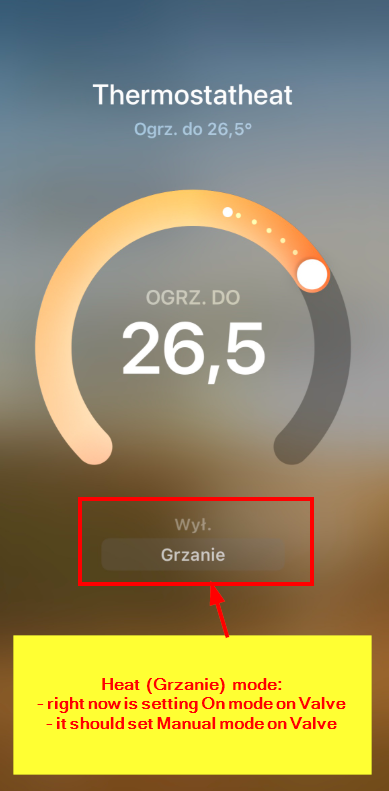

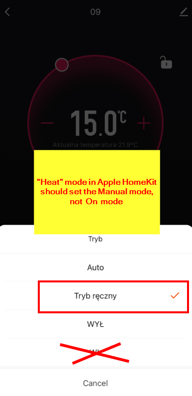

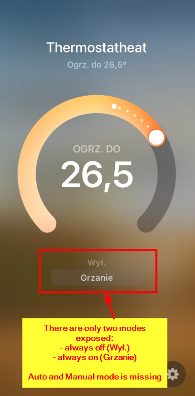

After some more poking around it turns out that if I add unresponding valve to scene in Apple HomeKit and configure it to set the temperature, and then run this scene, the valve becomes fully available and responsive. There is no need to remove and readd Hub back to Apple HomeKit to make it available. :)

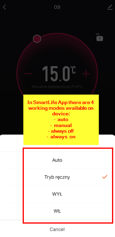

So the only request is to change the behavior of "Heat" (Grzanie) mode in Apple HomeKit to set the device to Manual mode, instead of On mode. For me there is no need to expose all four modes, only change the "Heat" mode behavior because it looks like it is not correct. When I use scene or automation in Apple HomeKit to set the desired target tempearture on Valve, it sets the Valve to On mode, instead of Manual mode and the thermostat built in Valve is not used.

Based on your text and pictures, I understand your requirement: to map Apple Home's Heat mode to Tuya's Manual mode, rather than the On mode. I have made the modification according to your requirements. Please restart the gateway, wait for the conversion file to update, and then verify.

I have restarted the gateway and waited approx. 14 hours and verified. Unfortunately, the behavior is still the same. When I set Heat mode in Apple HomeKit the Tuya mode is still On instead of Manual mode. I even removed and added again one of the sub-devices (Valve) to the gateway. Can you make the modifications again or guide me how to update conversion file?

Thank you for your assistance. I have readded all my subdevices and the Heat mode works as expected - it switches to Manual mode.
