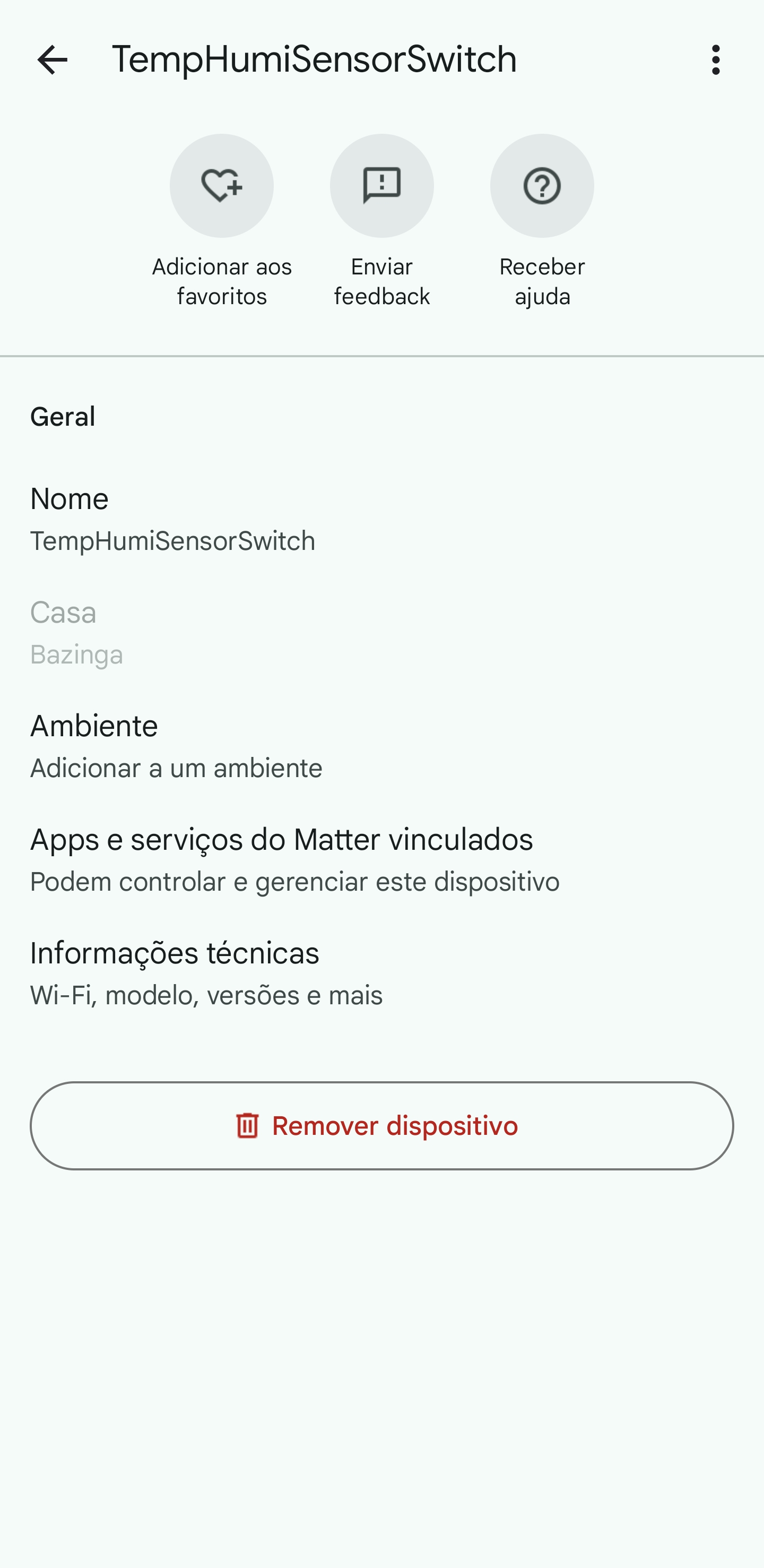

I confirm that the device has been configured as a temperature and humidity sensor and a switch, and its name is "TempHumiSensorSwitch". If it is not properly displaying the switch, could you take a screenshot to show me the Matter ecosystem details? Also, would it be convenient for you to verify it in other Matter ecosystems?

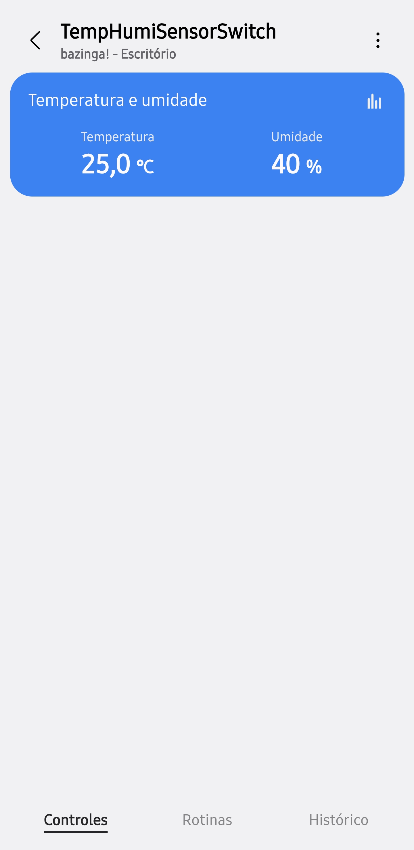

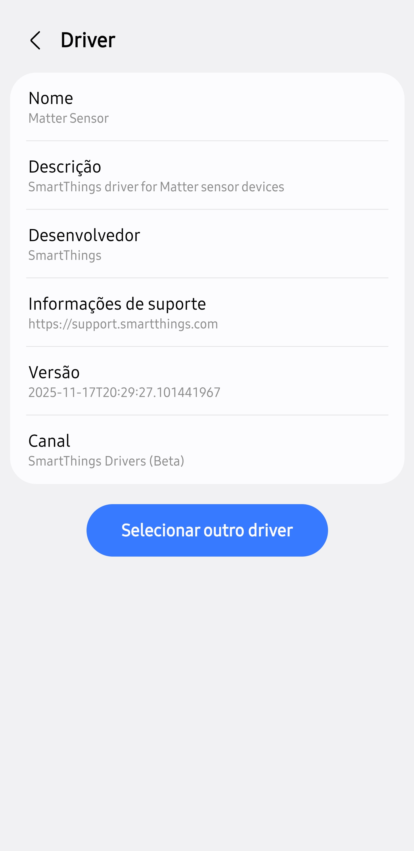

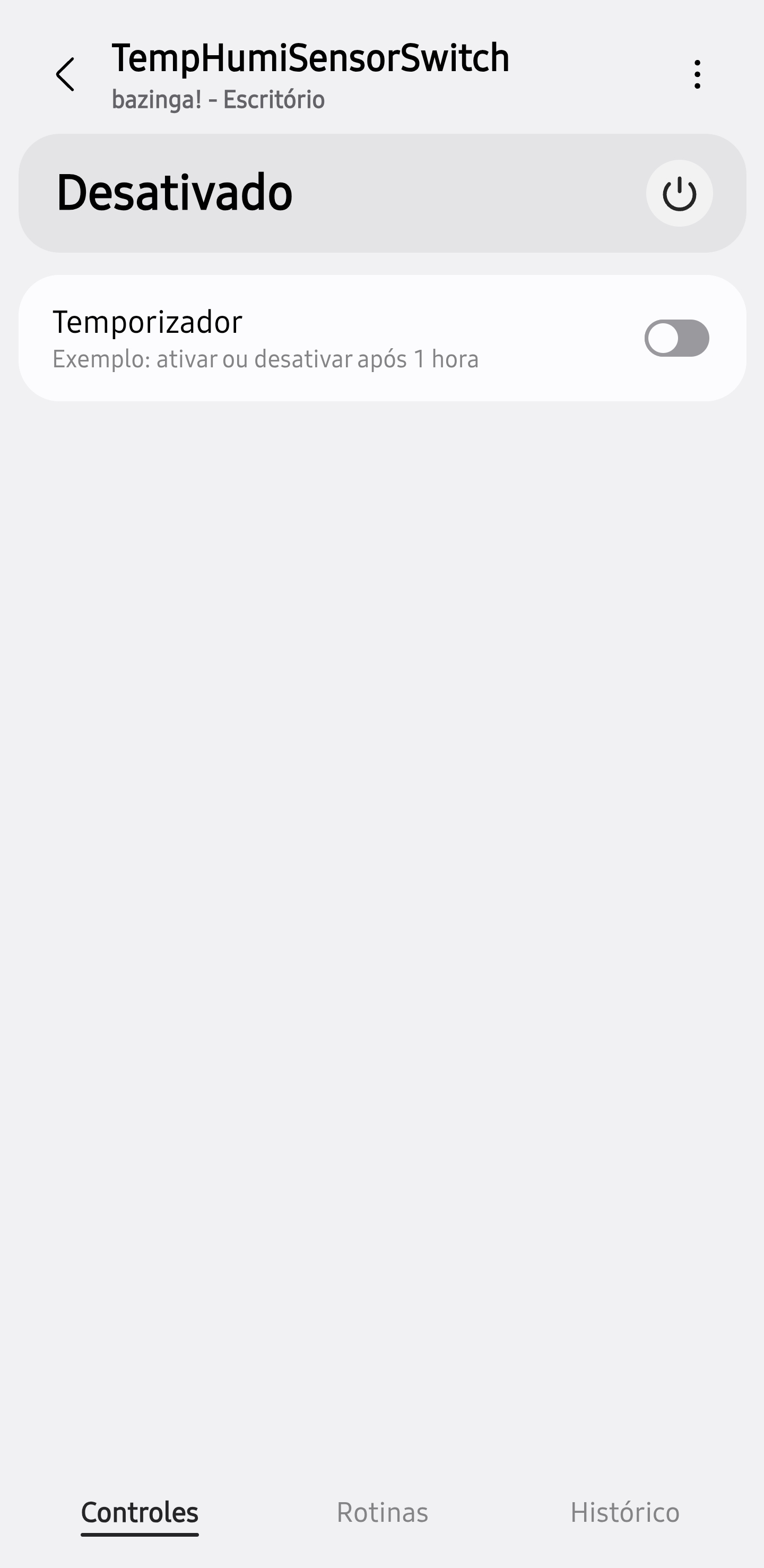

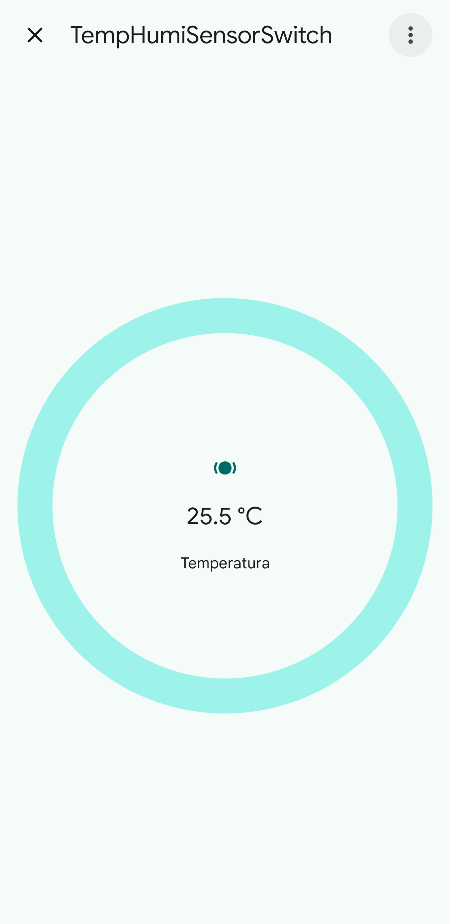

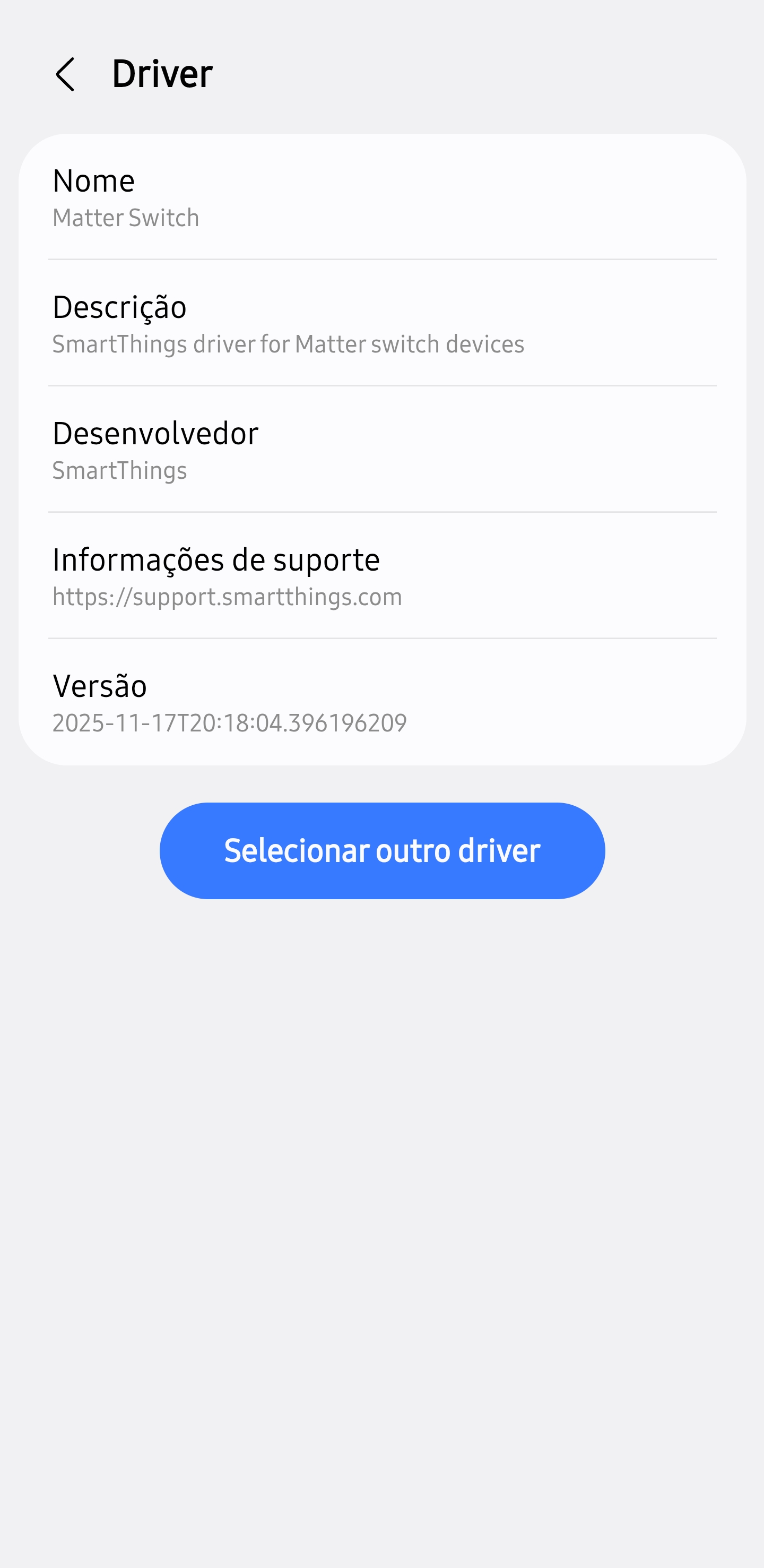

In SmartThings, only one device appears, which displays the temperature and humidity. However, if I change the driver for this device to a switch, the On/Off functions work normally, but the temperature and humidity readings disappear.

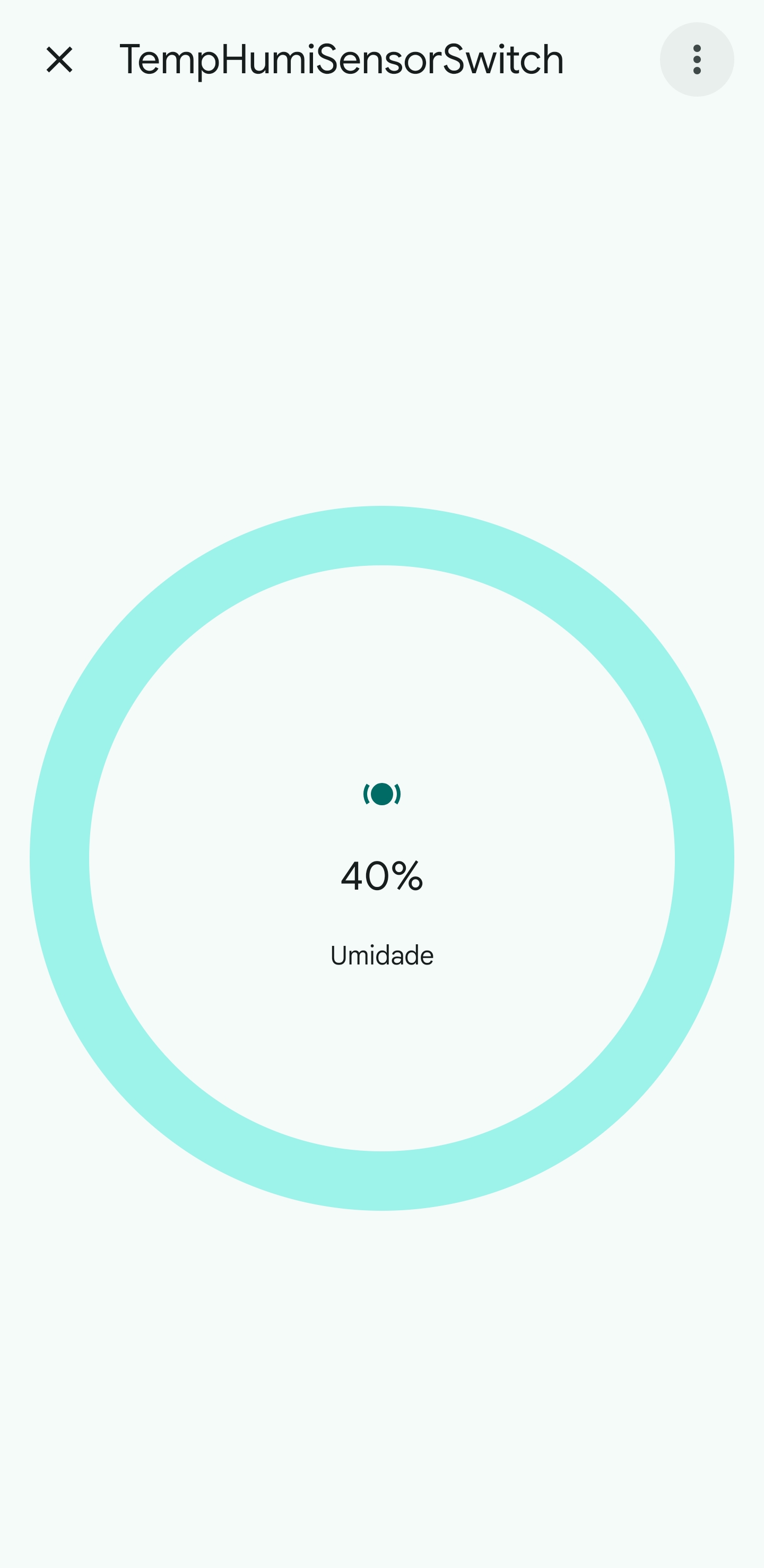

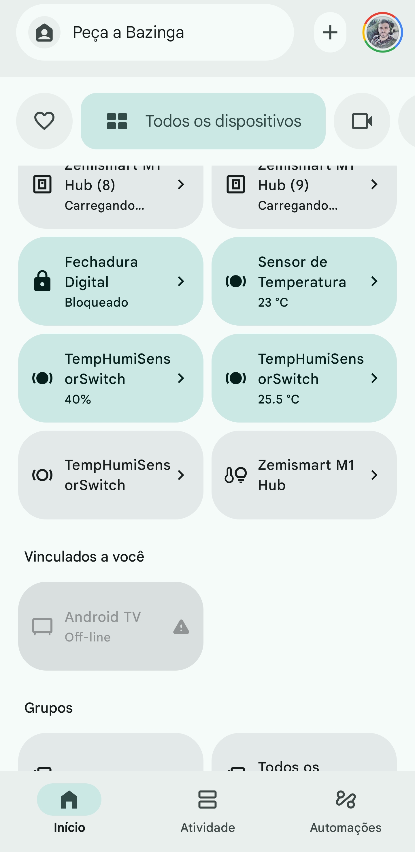

In Google Home, three devices appear: one temperature sensor, one humidity sensor, and one switch, but the On/Off functions don't work.
See the attachments
