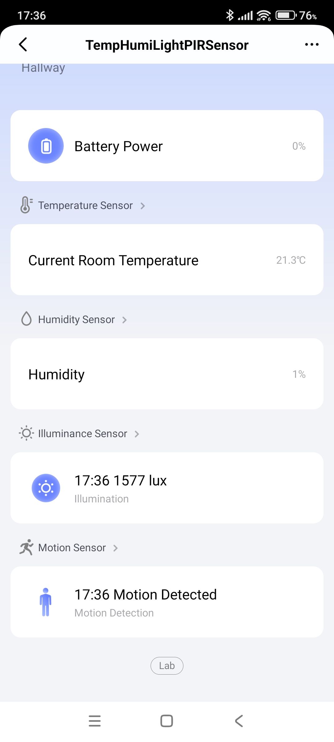

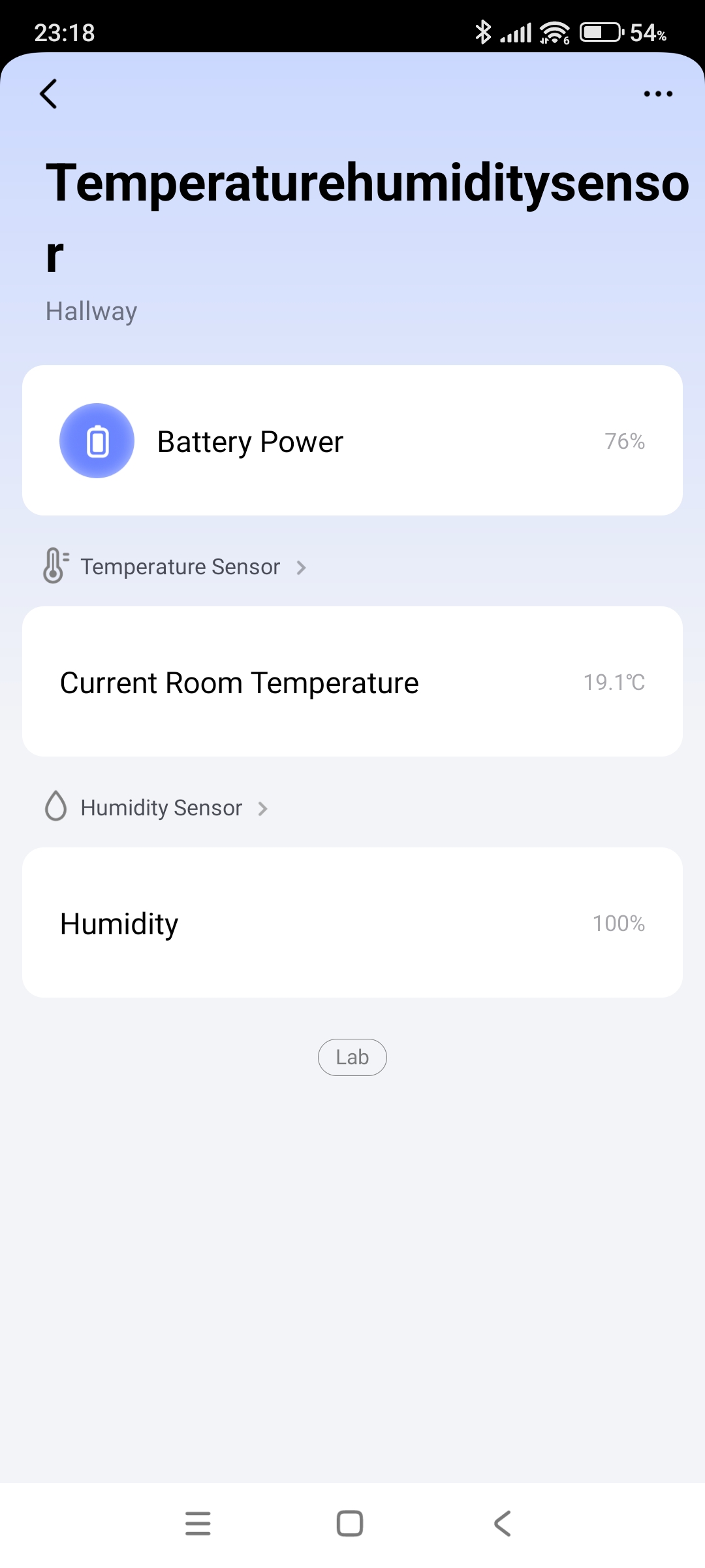

Humidity is always 100 percent, and temperature is always wrong compared to the Tuya app.
Presence sensor, movement sensor, and lux sensor are not exposed through Matter.

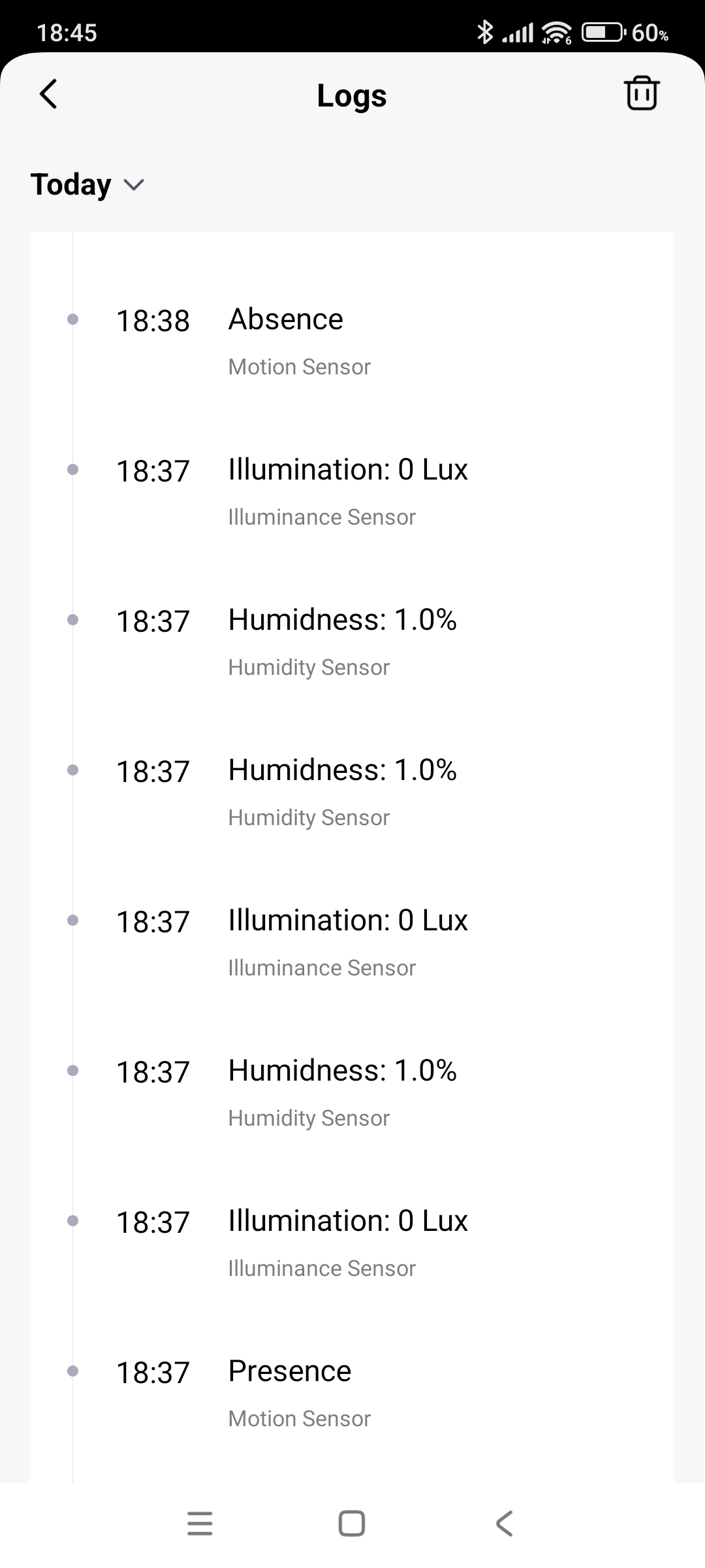

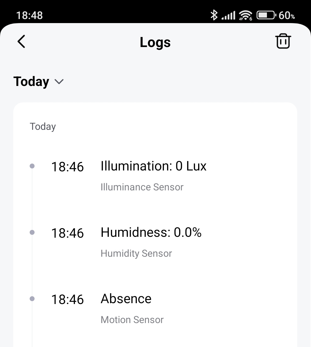

So I figured out why that sensor is reporting Humidness 1 percent or 0 percent plus illumination level.
When it detecting presence it keep spamming every second with data as long someone is around sensor:
Until there is an absence.
For presence it's always sending Humidness 1% and actual level of illumination.
When absence is detected then it sending once that data:
Humidness 0% and actual level of illumination.
Could you look again what it can be with reporting presence and absence? why it's sending humidness and illumination level constantly when someone is around sensor and once when there is absence. If you have few sensors it's really flooding matter controllers with a lot of data every second when presence is detected.

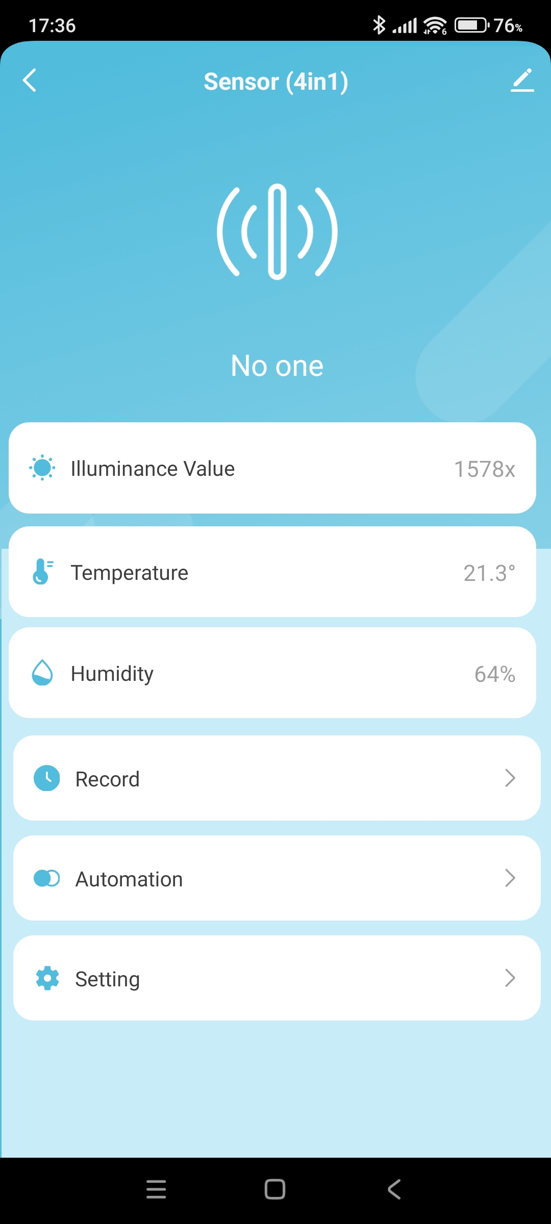

It's working normally in tuya, it's only sending that data to the matter controller through matter. All logs are from aqara app.
