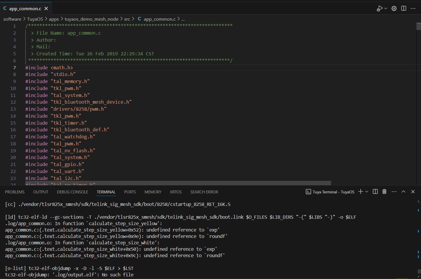

percy(unwired)
Posts: 18
Re: proxy to mesh failed error - TLSR825x SDK ver 3.8
Hi
I am using functions from math.h exp and roundf . I have included math.h in app_common.c however i keep getting the error
undefined reference to `exp'
undefined reference to 'roundf'
how do i fix this and include math.h during build
NICE
Posts: 100
The TLSR825x compiler does not support the standard library, and the telink non-standard library does not provide math-related functions. The chip manufacturer recommends implementing the required math functions yourself. We are also consulting chip manufacturers to see if they have any recommended third-party algorithm libraries.
