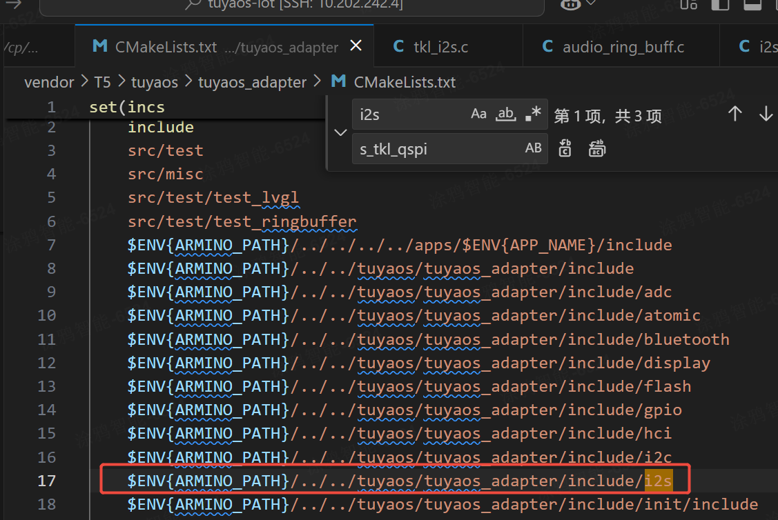

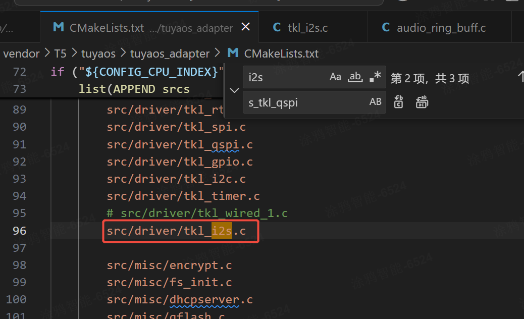

请将代码放至tkl驱动适配层vendor/T5/tuyaos/tuyaos_adapter/src/driver/tkl_i2s.c vendor/T5/tuyaos/tuyaos_adapter/include/i2s/tkl_i2s.h下进行使用,并修改vendor/T5/tuyaos/tuyaos_adapter/CMakeLists.txt文件,如附图17531772406217.png、17531772232866.png所示
添加对应文件编译路径
