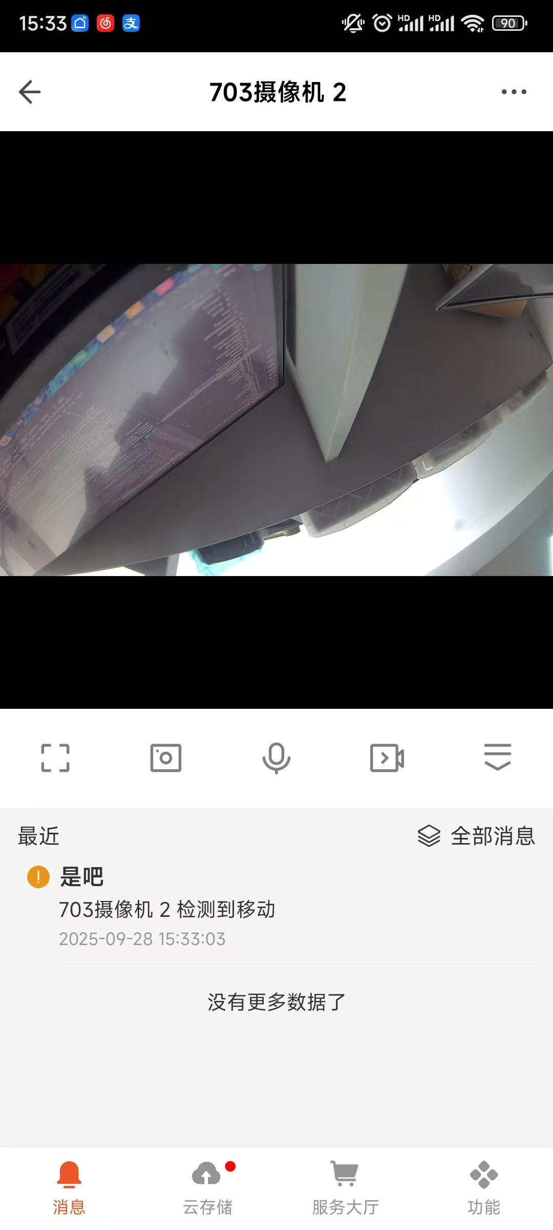

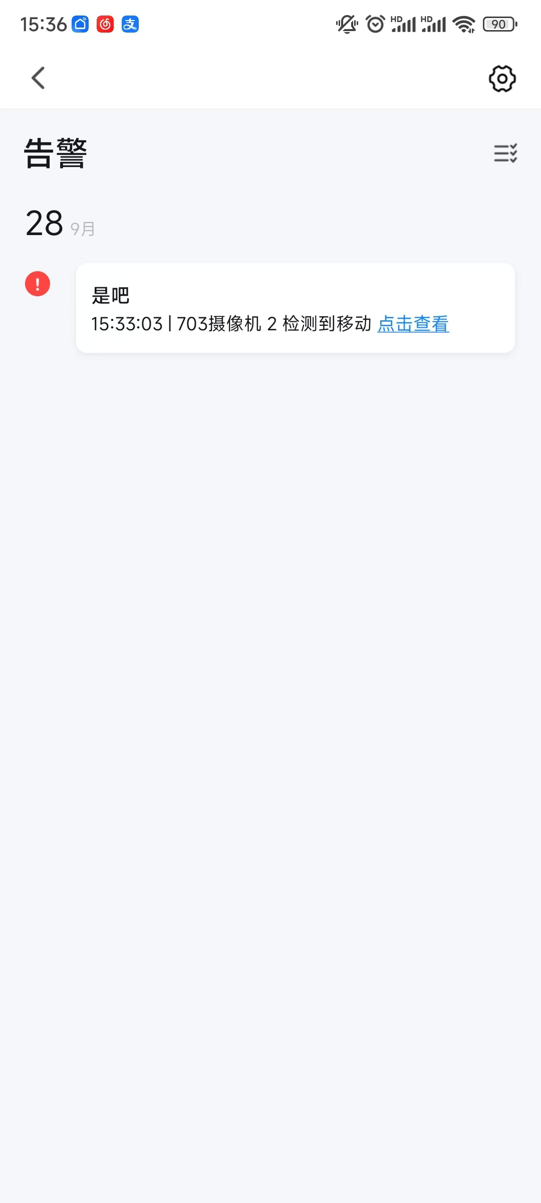

【求助】【TuyaOS SDK】【T32_uclibc_r337_TuyaOS-3.10.16】事件告警主动上报没有显示图片?
chenhongji
Posts: 9
代码:
void send_text_alarm() {
TUYA_ALARM_T alarm_info = {0};
alarm_info.type = E_ALARM_MOTION;
alarm_info.is_notify = TRUE;
alarm_info.trigger_time = tal_time_get_posix();
alarm_info.upload_time = 0;
alarm_info.valid = 1;
alarm_info.force = 1;
alarm_info.resource_type = RESOURCE_PIC;
alarm_info.pic_buf = __2_jpg; //图片
alarm_info.pic_size = __2_jpg_len; //图片
alarm_info.extra_data = NULL;
alarm_info.context = NULL;
alarm_info.context_cnt = 0;
alarm_info.media = NULL;
alarm_info.media_cnt = 0;
// 调用函数发送报警信息
OPERATE_RET ret = tuya_ipc_trigger_alarm_without_event(&alarm_info);
if (ret == OPRT_OK) {
printf("文本报警信息发送成功----------------------------------------------------\n");
} else {
fprintf(stderr, "文本报警信息发送失败,错误码:%d\n", ret);
报错:
WIFI Get Mode [] 2
[09-28 15:33:30 ty E][be30][tls_transporter.c:53] tcp transporter connect failed,ret:-0x710a
[09-28 15:33:30 ty E][be30][http_inf.c:73] Open session failed: https://ty-cn-storage30-1254153901.cos. ... 44783.jpeg (-28938)
[09-28 15:33:30 ty E][be30][cloud_operation.c:1762] http_inf_client_put fail:https://ty-cn-storage30-1254153901.cos. ... .jpeg,size: 208592, ret -2050, cost 5265 ms
[ 513.876823] rwnx_do_ioctl cmd 35585
[ 513.885679] rwnx_do_ioctl cmd 35585
vnet0 no wireless extensions.
pippin-bobo
Posts: 262
Re: 【求助】【TuyaOS SDK】【T32_uclibc_r337_TuyaOS-3.10.16】事件告警主动上报没有显示图片?
TCP连接报错了,确认下设备网络是否正常?这个是必然出现还是网络抖动才会出现?
