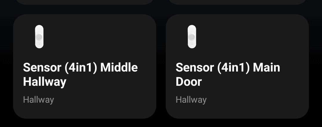

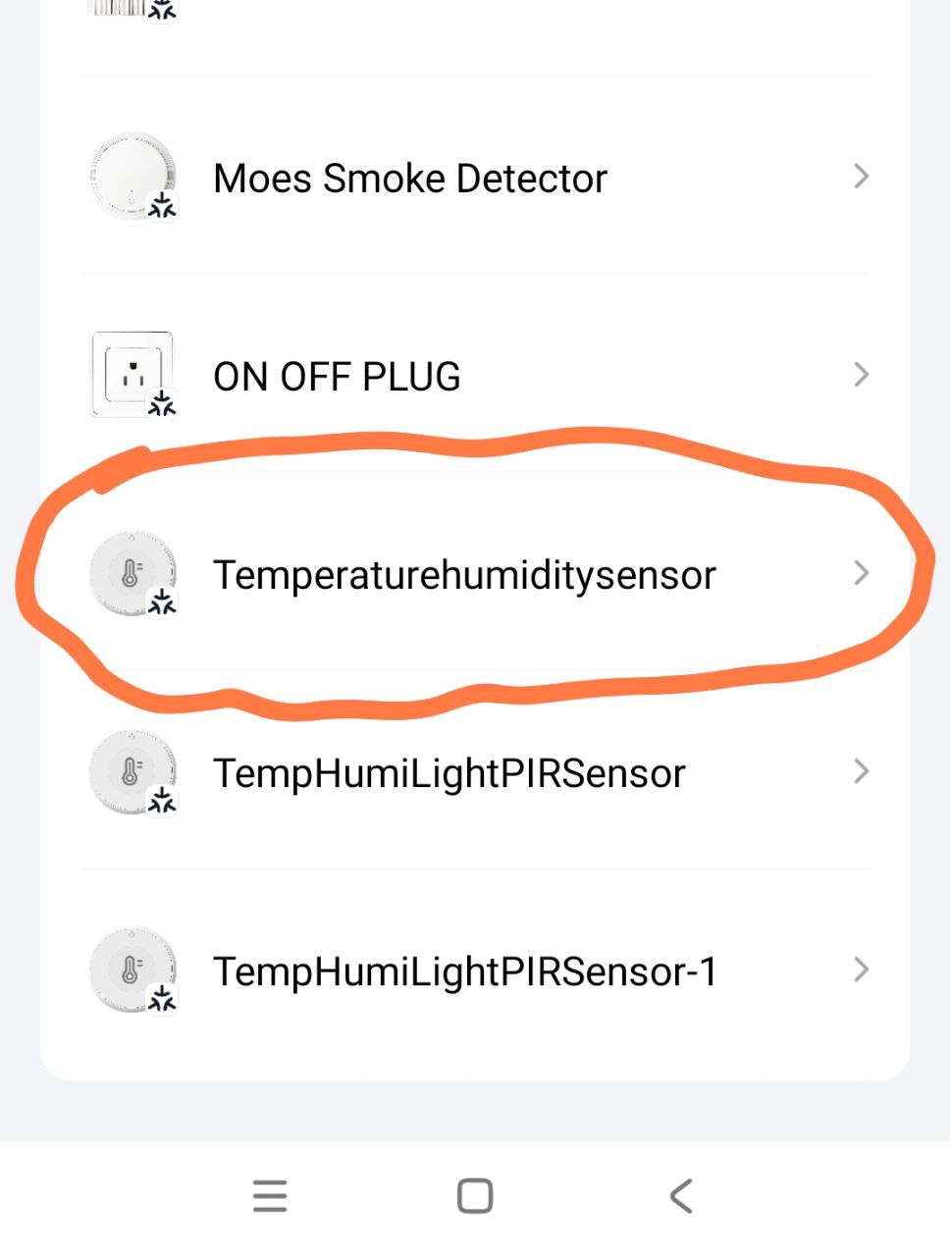

No, it's not exposed. I restarted the gateway, but I can't unbind and bind these devices again at this moment, I'm at work. Normally added devices are exposed instantly, even without restarting the hub.
All exposed devices:
(these 6 switches are different devices)
