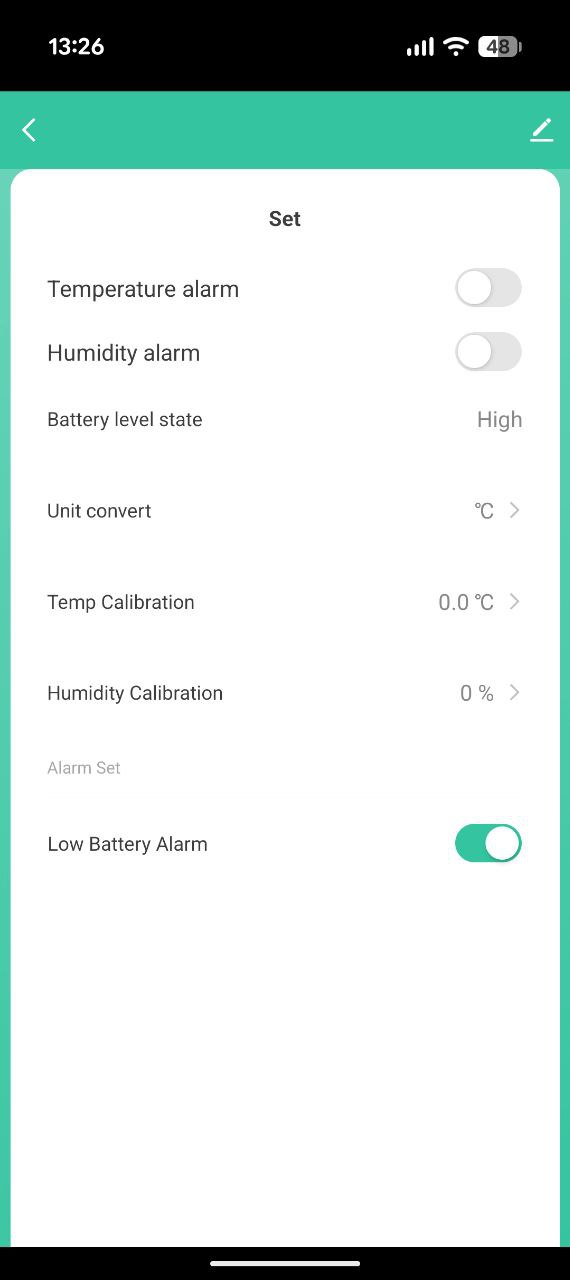

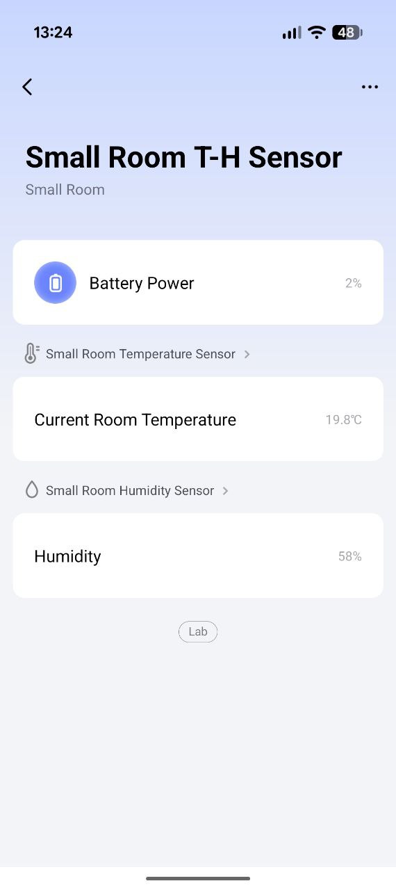

It's keeping reporting battery status as 2%, I think its beacuse in tuya app, battery level status is high, normal, and low. So I think it's better just turn off battery status in Matter, or make that high is reported as 100%, normal as 50%, and low maybe as 10%.
Battery Status In Aqara App:
Battery Status In Tuya App:
Virtual ID: bf118a868a72f10be5g134

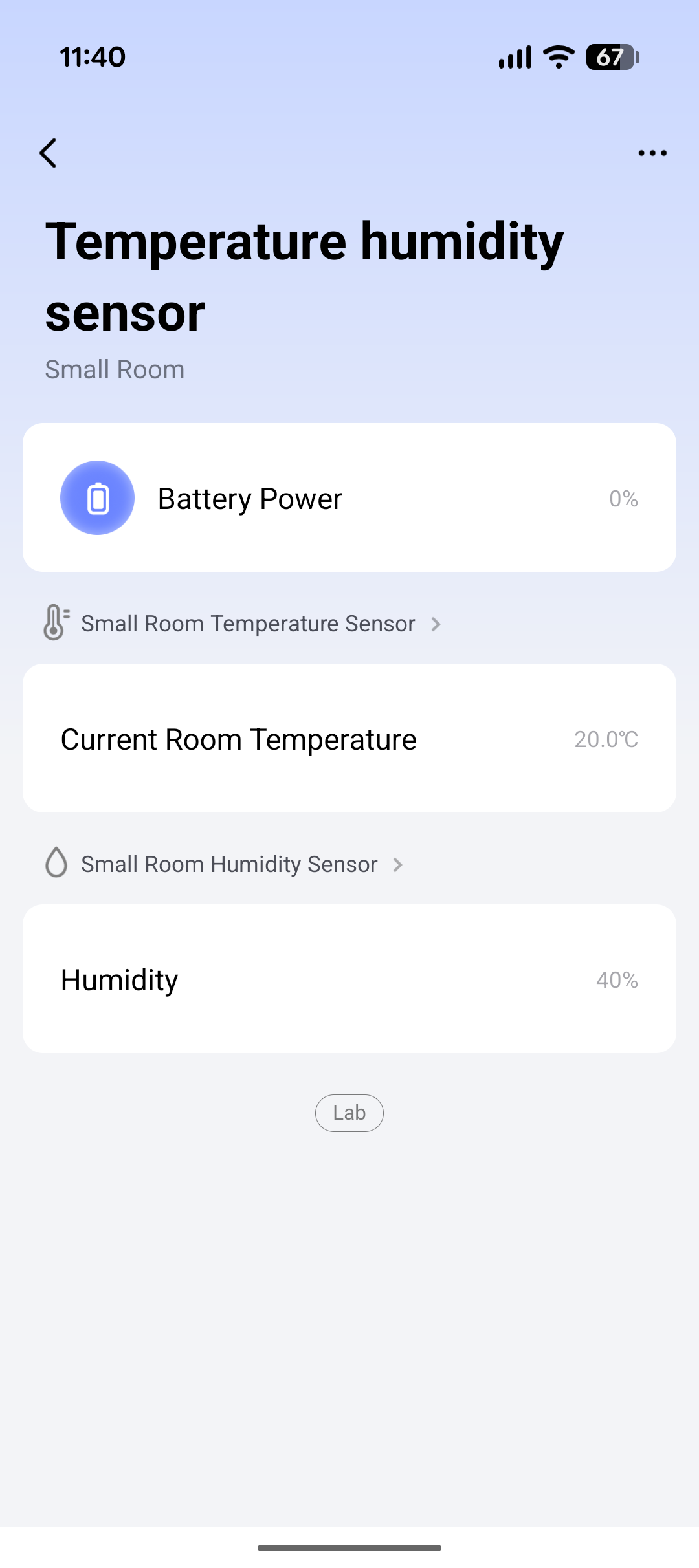

It has been updated. You need to unbind it and (ideally restart the gateway) rebind it to trigger the change.
It's now 0 percent:
But if it can't be fixed, then it's ok, it's better than 2 percent hah, and no big problem.
