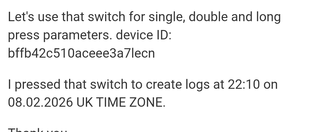

Thank you for being so helpful. I appreciate it.
I will share further updates when Aqara responds.
