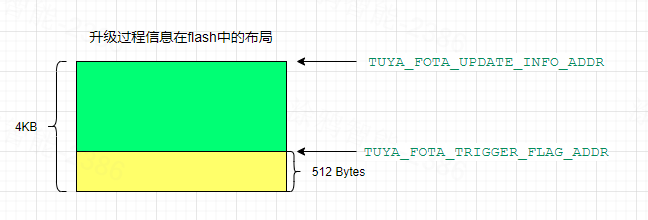

      该函数功能返回升级标识相关及升级结果信息在flash中保存扇区的相对起始地址 TUYA_FOTA_UPDATE_INFO_ADDR,长度预留一个扇区大小即1024*4(4KB)
    • Code: Select all
      * @brief get the offset address to save trigger fota indicator
      * @param[inout] out_addr :output the offset address
      * @return OPRT_OK on success. Others on error, please refer to tuya_error_code.h
      OPERATE_RET tkl_nbiot_get_fota_trigger_flag_offset(UINT_T *out_addr)
          *out_addr = TUYA_FOTA_TRIGGER_FLAG_ADDR;
          return OPRT_OK;
      该函数功能返回升级标识相关及升级结果信息(为fota_update_info_t数据结构)在flash中保存扇区的实际相对起始地址TUYA_FOTA_TRIGGER_FLAG_ADDR
    • 函数tkl_nbiot_get_fota_update_info_offset及tkl_nbiot_get_fota_trigger_flag_offset所返回在flash中所指定的地址建议如下:
