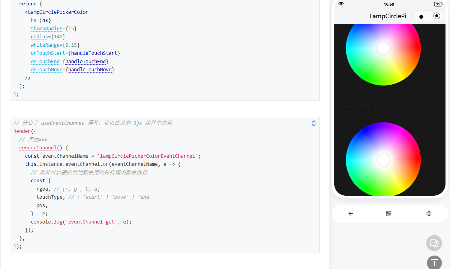

智能小程序怎么使用物料里面的开启了useEventChannel 属性下的方法
陈先生
Posts: 34
需要获取到移动时当前位置在色盘上的颜色值
Render({
  // 其他xxx
  renderChannel() {
    const eventChannelName = 'lampCirclePickerColorEventChannel';
    this.instance.eventChannel.on(eventChannelName, e => {
      // 此处可以接收到当颜色变化时传递的颜色数据
      const {
        rgba, // [r, g , b, a]
        touchType, // : 'start' | 'move' | 'end'
        pos,
      } = e;
      console.log('eventChannel get', e);

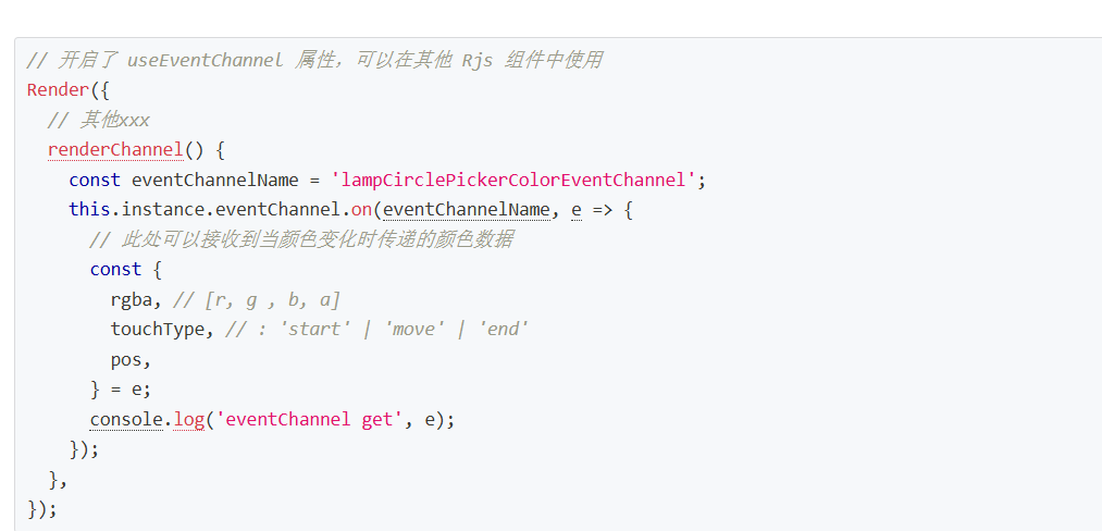

Re: 智能小程序怎么使用物料里面的开启了useEventChannel 属性下的方法
请查看物料平台对应组件的示例代码,有写

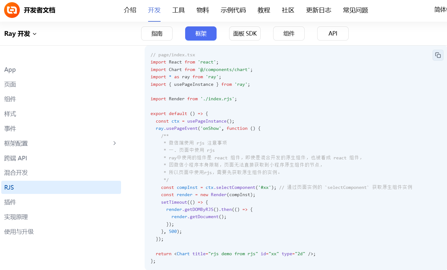

智能小程序开发者
Posts: 198
我猜你可能不清楚RJS的相关概念,可以看一下这个文档,或许能对你有所帮助。如果还不清楚如何使用可以把文档看不懂的地方告诉我们
https://developer.tuya.com/cn/miniapp/d ... ork/render

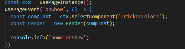

陈先生
Posts: 34
获取原生组件实例报错
/* eslint-disable prettier/prettier */
import { location, usePageInstance , usePageEvent } from 'ray'
import React from 'react'
import { Button, View, Text } from '@ray-js/components'
import { LampHuePicker, LampCirclePickerColor } from '@ray-js/components-ty-lamp'
import Render from './index.rjs';
import { IProps, TProps, HS } from './props'
import styles from './index.module.less'
export default function Home() {
  const fooRef = React.createRef()
  const [hs, setHS] = React.useState({ h: 266, s: 1000 })
  React.useEffect(() => {
    console.info('home did mount', location)
    console.log(fooRef.current)
const handleTouchStart = (hsRes: HS) => { setHS(hsRes) } const handleTouchMove = (hsRes: HS) => { console.log(hsRes, 'handleTouchMove') console.log(hs, 'hs') // setHS(hsRes); } const handleTouchEnd = (hsRes: HS) => { setHS(hsRes) } const ctx = usePageInstance(); usePageEvent('onShow', () => { const compInst = ctx.selectComponent('#PickerColors'); const render = new Render(compInst);
console.info('home onShow') }) usePageEvent('onHide', () => { console.info('home onHide') }) usePageEvent('onPageScroll', (event: any) => { console.info('onPageScroll', event) }) usePageEvent('onReachBottom', () => { console.info('onReachBottom') }) usePageEvent('onResize', (event: any) => { console.info('onResize', event) }) return (
<View className={styles.view} > <View className={styles.PickerColor} > <View className={styles.InnerCircle}><Text className={styles.TextM}>M</Text></View> <LampCirclePickerColor id='PickerColors[attachment=1]Snipaste_2024-07-25_11-13-56.png[/attachment][attachment=2]Snipaste_2024-07-25_10-02-59.png[/attachment]' hs={hs} thumbRadius={5} radius={120} whiteRange={0.1} onTouchStart={handleTouchStart} onTouchEnd={handleTouchEnd} onTouchMove={handleTouchMove} useEventChannel /> </View> </View> ) }
export default Render({
  renderChannel() {
      const {
        rgba,
        touchType,
        pos,
      } = e;

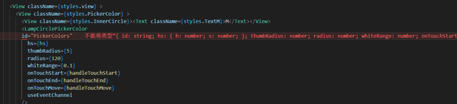

陈先生
Posts: 34
定义了id的ts类型为字符串,还是获取不到LampCirclePickerColor组件的实例,该如何使用?
