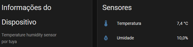

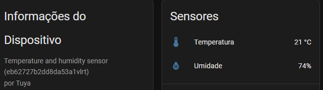

OK values: 21 C / 74 %
Wrong values: 7,4 C / 10 %

qiusui
Posts: 150
Re: Devices are not exported to Home Assistant as Matter
Hi JorgeFrancisco,
I have updated the configuration. Please remove these devices, reconfigure the gateway, and then perform the bridging operation so that the configuration takes effect.
Give it a try. If there are still any questions, please leave a message to tell me.

Temperature values ​​are ok, but humidity values ​​need to be multiplied by 10
qiusui
Posts: 150
ok, It's a minor problem. I'll fix it immediately.
