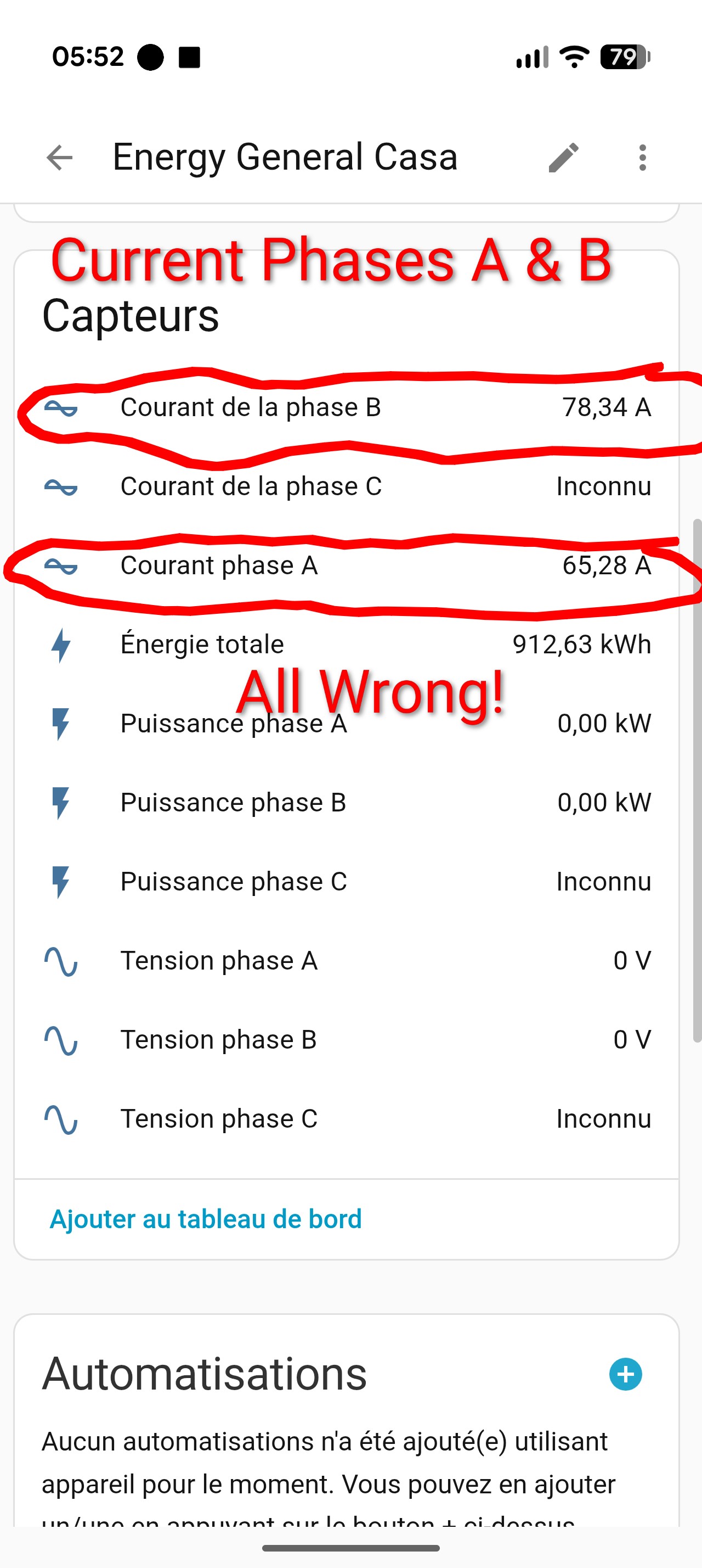

Home Assistant Official Tuya Integration wrong values

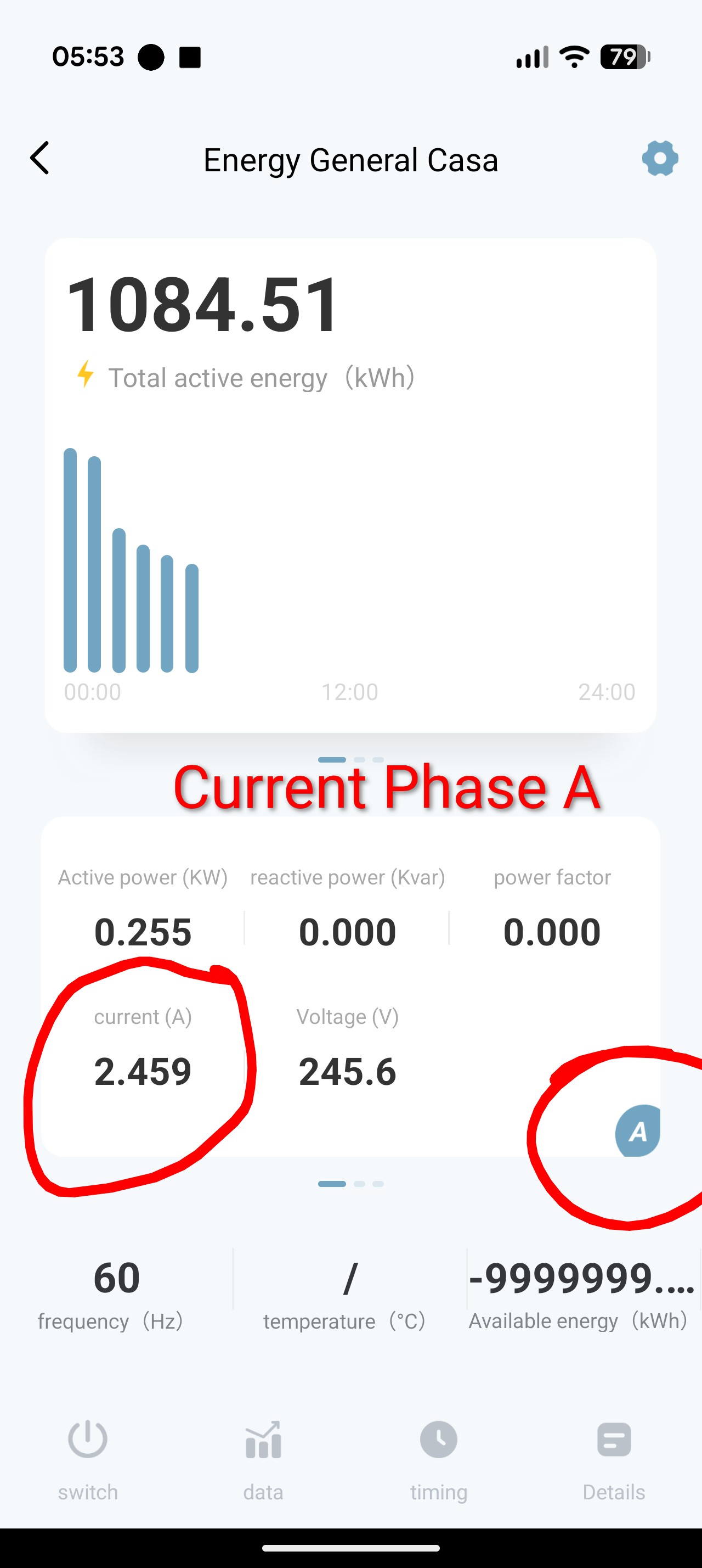

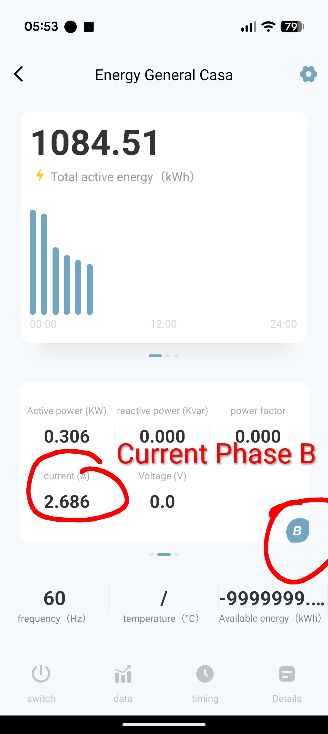

SmartLife App - Amp. Current Phase B correct value
SmartLife App - Amp. Current Phase A correct value
